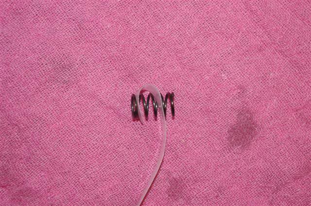

I just bought a KLX205S Saturday. Changing out all the fluids so I know what I got. Ran into the spring... Here's my milk jug tool:
Here's a video if you're really bored and have a minute and a half to blow:

The service manual shows a dab of grease on the back of the filter. Didn't see that until after I made my tool. I don't like the idea of bending the spring... because it'll break on me and find it's way into the motor. That's the kinda luck I have.
