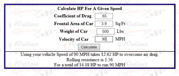

Edit...So I lifted these words from Wiki and using the worst numbers they(http://www.wallaceracing.com/Calcula...or%20Speed.php) cite for Cd and frontal area come up with less than 15HP needed for aero and rolling resistance combined. Perhaps for commuting duty I can install lower narrow handlebars in addition to a small windscreen. Of course torque not HP is what results in tire to ground force which will be reduced as I go smaller. I think I will use KLXSTER's dyno reports and see what number crunching finds.
The dimensionless measure of drag coefficient, Cd, varies from .55 to .65 (comparable to a pickup truck), vs Cd .29 for many sports cars and even .20 for high efficiency cars. However a more relevant figure of merit, CdA, factors in the vehicle's frontal area, and thus actual power required to overcome wind resistance.[15] A typical projected frontal area for motorcycles is in the neighborhood of 2.9–3.9 sq ft (0.27–0.36 m2).
