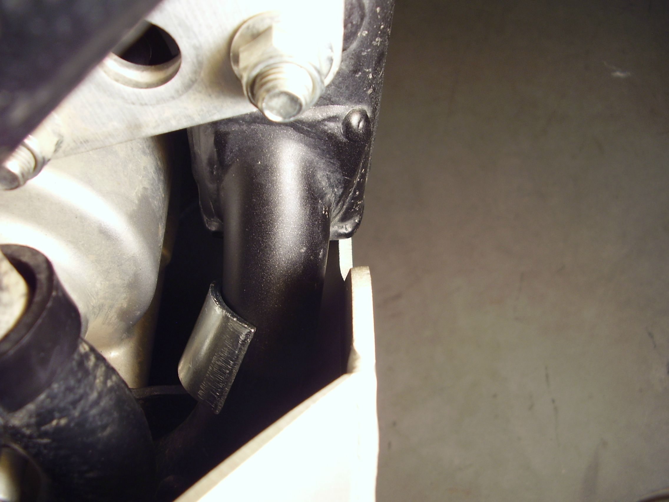

I took another go at putting it on now that its a tad cooler. Luckily I only galled the threads and didn't cross thread anything. I put some oil on the bolts and they went right in. The cross brace is visibly bent but I think the welds are still good.
The issue seems to be with the front of the plate and the hangers. I put the plate on without the hangers and it fit muuuuuuch better. Everything lined up right and went right on.
The front of the plate does not actually touch my frame. It buts up against the square stock on top and then protrudes away from the frame. That is why I had so much trouble. The first time around I started with the hangers and moved back. Everything was out of whack from square one. Is it normal for the hangers to fit this poorly?
Gap between plate and frame.

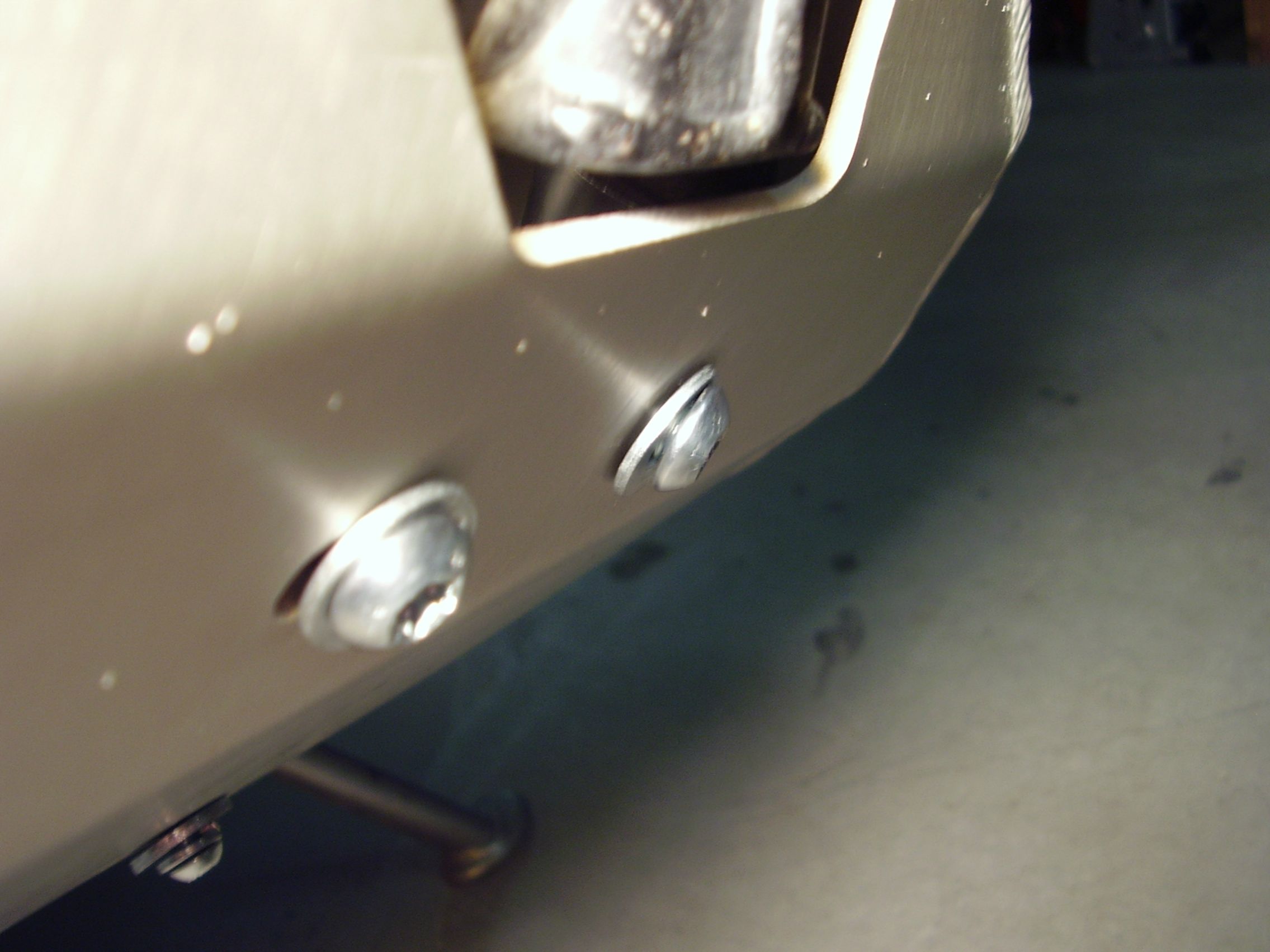

Bolts do not fit flush and bind on slot.

I just put one on my bike and it fit fine. The two front hooks that clamp the frame I tightened down until they bent to conform a bit but I didn't over do it. I did notice the two different length bolts but now I'm concerned about them interfering with the crank case. I'll look when I get a chance. Maybe yours was a bit tweaked, sucks but it's bound to happen any time you buy a fabricated product like this.
