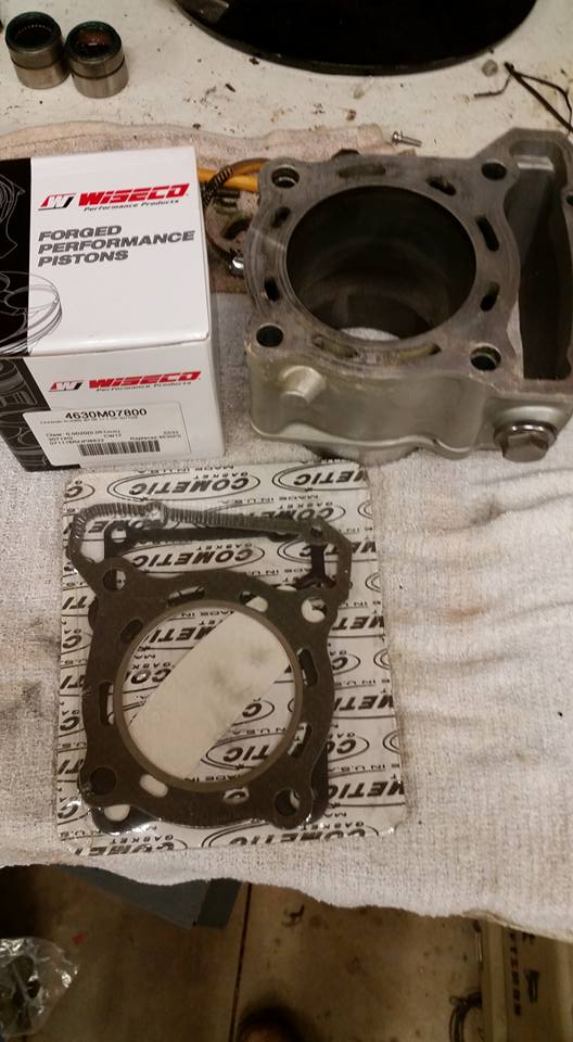

Parts are here, though I won't have time to start the rebuild for a couple weeks.
