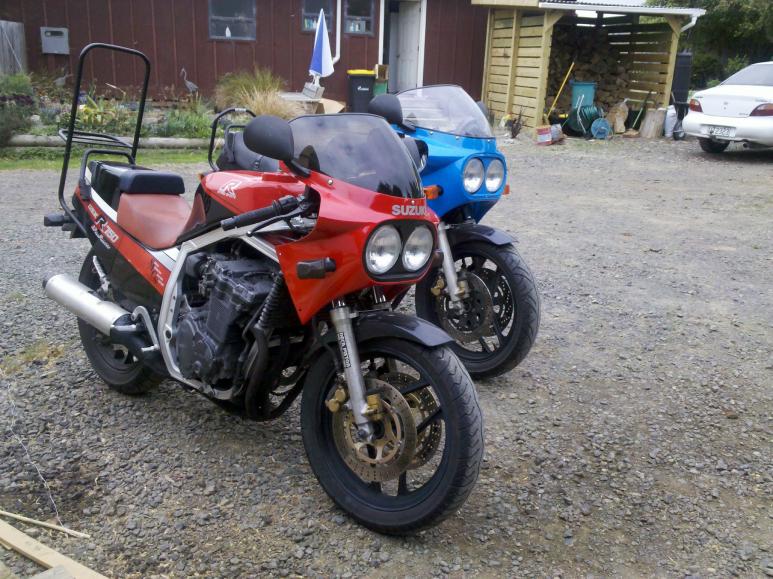

Originally Posted by klx4me
My mate is rebuilding one of these at the moment. I can't wait to he is riding it again. A real classic.
My son and I have one each
