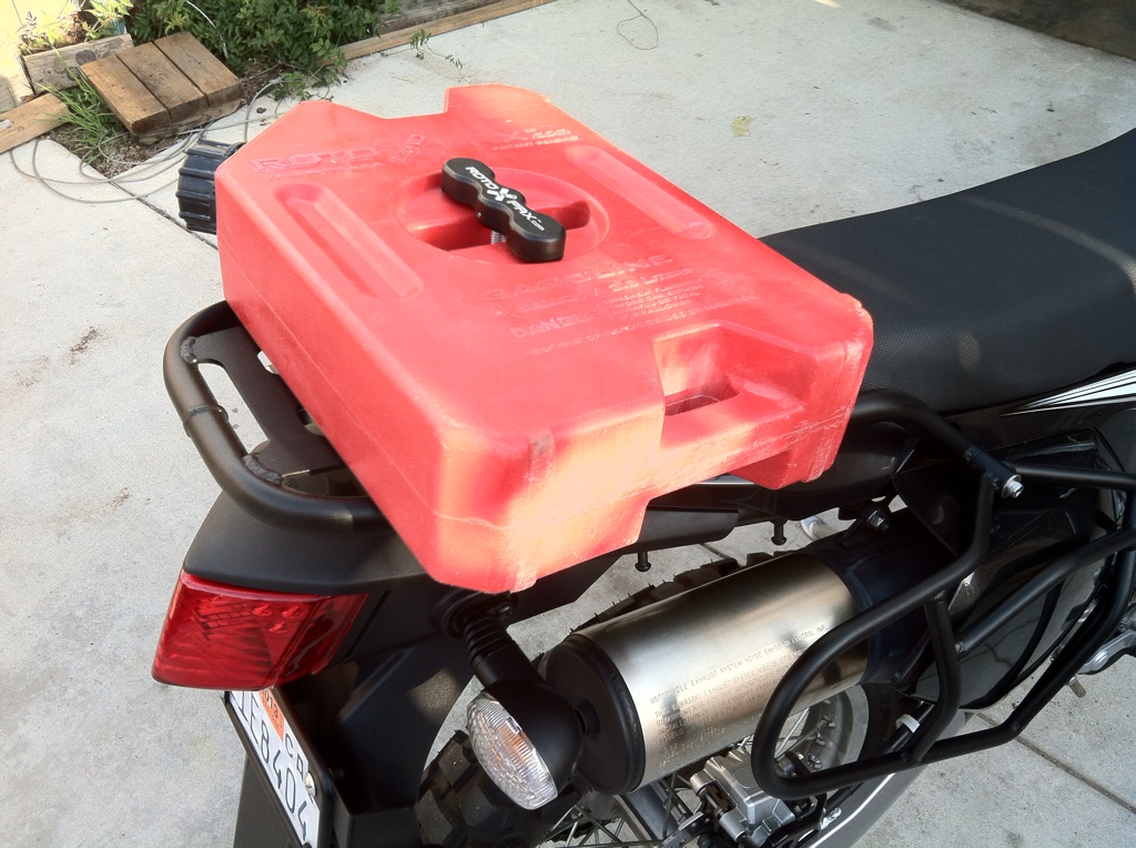

pm racks made a new rack that can accept the roto pax mount

I like the pm rack, but they dont fit the 07.
Old Jul 26, 2013 | 04:04 PM
MikeW's Avatar
Joined: Sep 2012
Posts: 434
From: Sandy Eggo
yeah I dont think he can get a bike easily enough to make one, since they were never sold in cali
Old Jul 27, 2013 | 05:16 AM
AZR's Avatar
AZR
Joined: Nov 2012
Posts: 53
Hopefully one comes his way someday. The pm rack looks like the best Ive seen.
