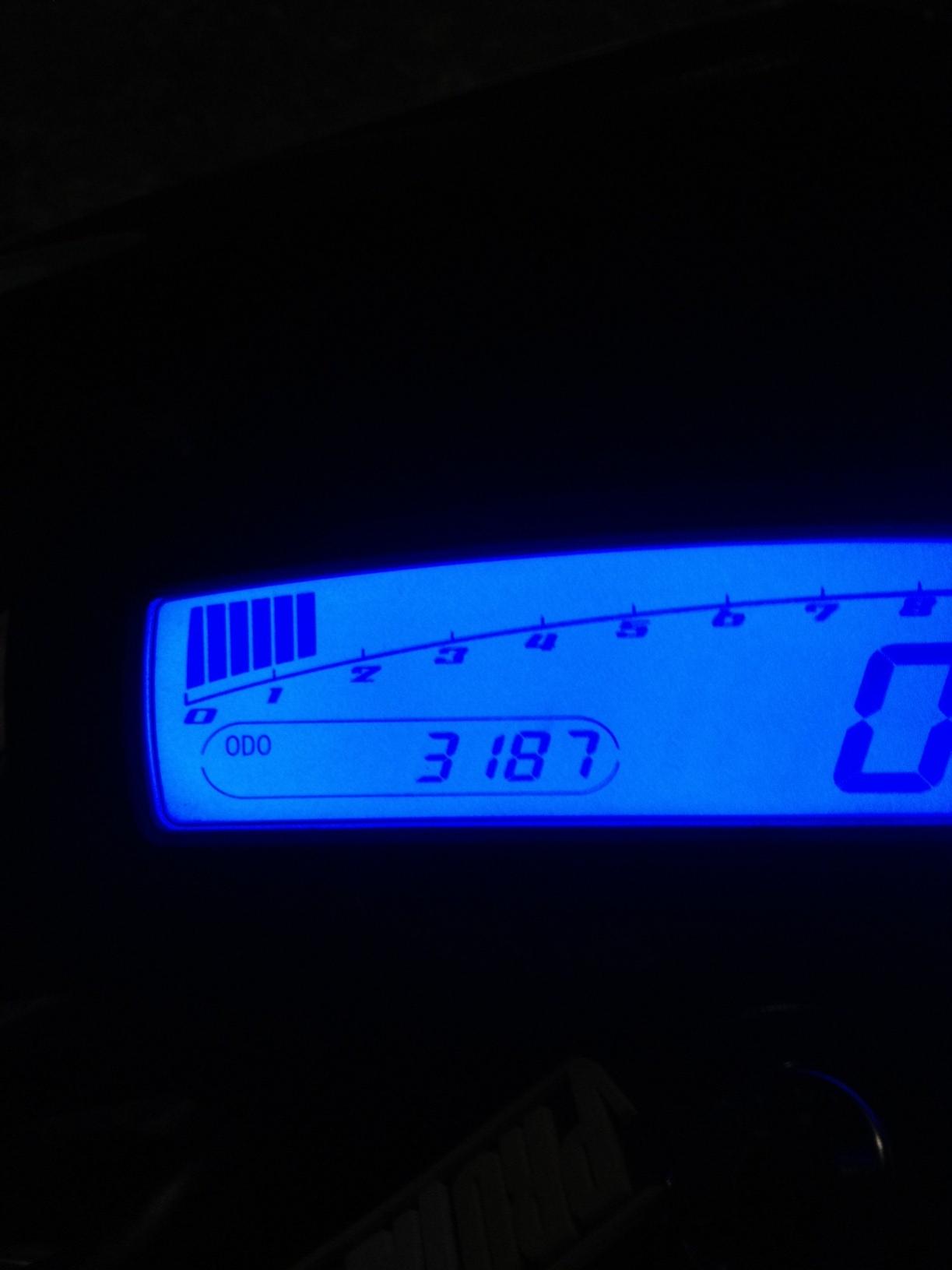

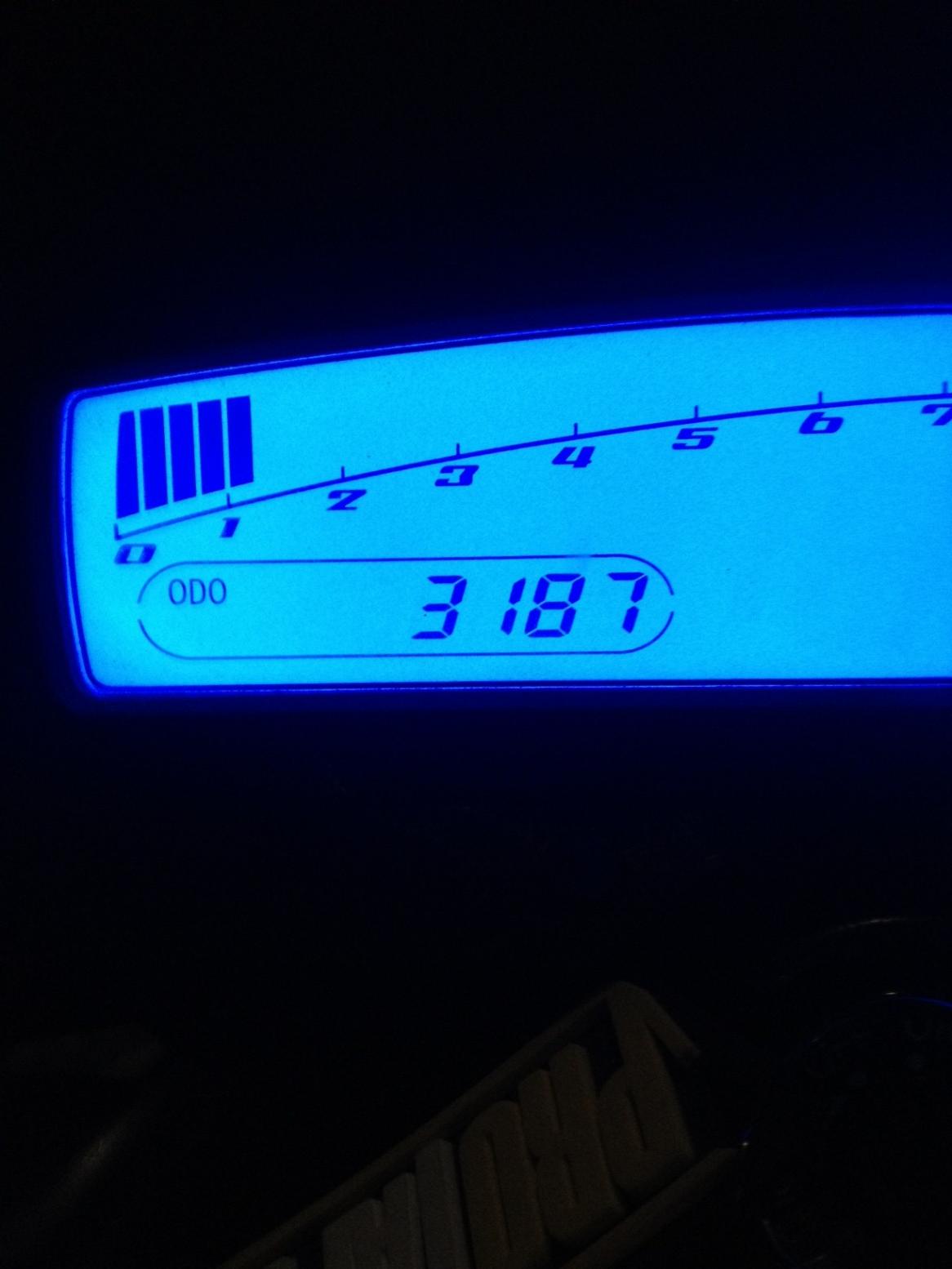

Also is proper idle (1300 rpm) one bar or two bars after 1000 mark.(see pic below)

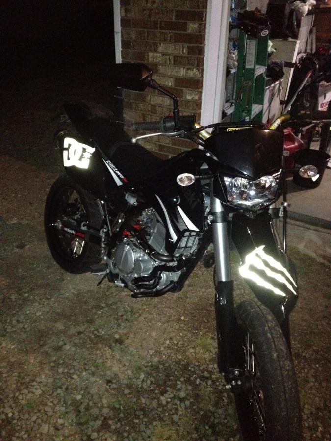

P.S. Not sure if I ever showed you guys the reflective decals I made. They are black during the day but when lights hit them at night they reflect white!
