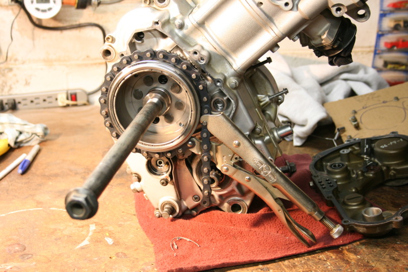

This is how I removed it last winter when I replaced my engine cases. I couldn't see buying a specialty tool and waiting for it to come. I came up with the chain strap after looking around my workshop. Chain strap did not require too much pressure, and I wrapped a piece of rubber around the flywheel before applying the chain strap. The rear axle is the correct thread for the flywheel and , in my case, this set up worked like a charm.
Old Feb 18, 2014 | 09:13 PM
When doing my engine , I found an old post from DDT that gave me the rear axle trick.
My engine tear down.
https://www.kawasakiforums.com/forum...s-39378/page6/
Quote from my engine rebuild thread.
"The rear axle works like a charm to pull the flywheel. ( on my 07 klx at least) I had already figured out that I could use my vise grip locking chain wrench for a flywheel holder. Now with that holding the flywheel,a bit of heat from the heat gun, the rear axle threaded in to push on the crankshaft, and a few whacks with my had on the ratchet it popped loose.
Ta-effing-da! Thanks DDT, I think he sold his klx and moved on to something bigger over there in Japan, but his valuable little tidbit of information, saved me a little money and most of all a lot of time! Maybe I won't forget the tip this time.
Dan
ddt's thread https://www.kawasakiforums.com/forum...al-tool-26452/

Rear axle trick did not work for me, could not thread on far enough to really get any pressure.... ended up at the shop for the removal.
