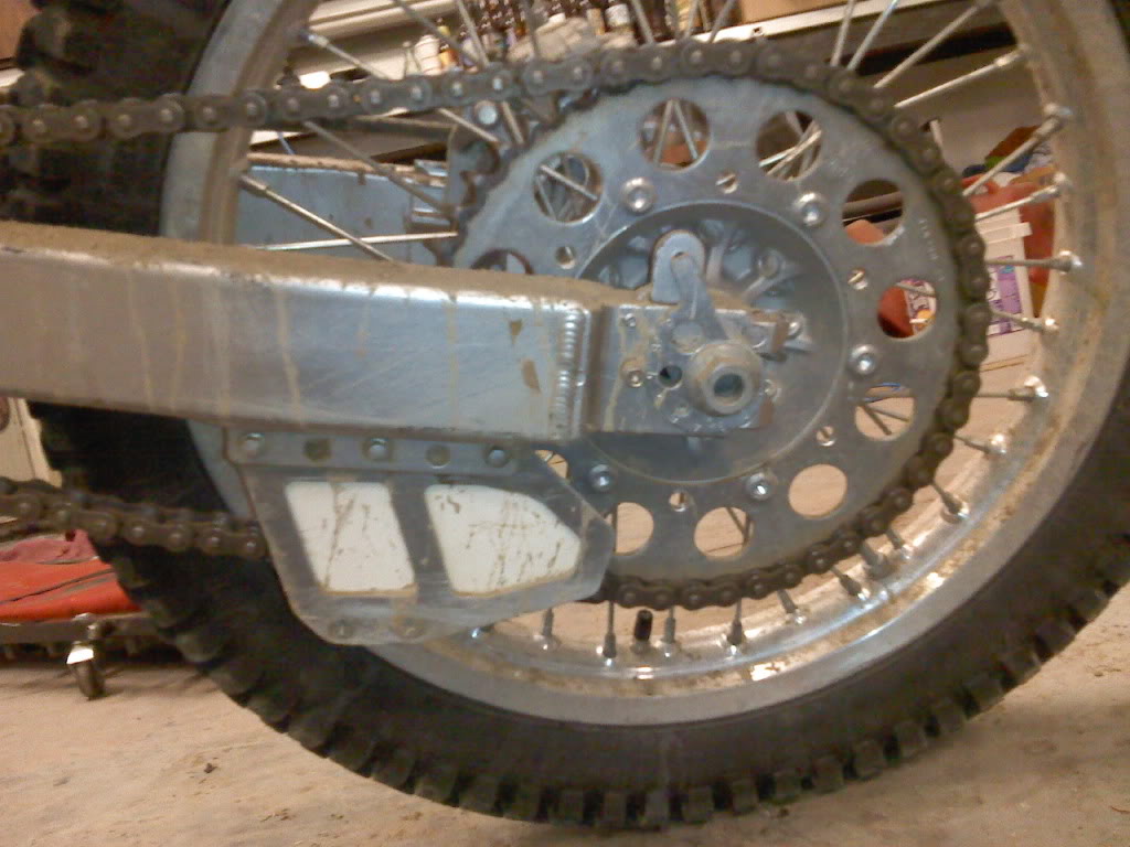

Yes, the '06-'07 models look like the pic below and don't easily lend themselves to fine-tuning alignment.

It does seem like the adjustments are a bit too large anyway. It would be better with finer increments.
At this point since my cam is not touching the pin on one side it may slide with use. However, the worst it will do is slide until it contacts and that is about where it started. Not as good a line but it should not be an a big deal.
I could see if it would go to the next spot but its aligned well now and I hate to mess with it.

WOW! The '09 setup is much better to get things setup symmetrical. OTOH, it takes a lot longer to loosen the chain (i.e. for counter-sprocket changes) than it would with the older setup.
