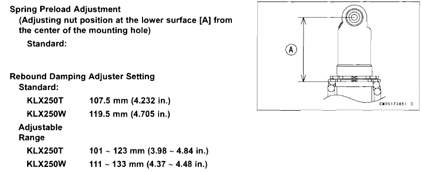

I don't think we're measuring the same way. I'm measuring from the center of the top shock to the top of the spring like the shop manual shows. I'm still in the range. With my gear on I'm at 97mm sag. The bike did fine today without the lowering links. I only almost fell over once. Ok maybe twice.
Oh, OK...you're measuring the exposed thread area?...if I'm reading you correctly? Yeah, I've seen that mentioned in the shop manual, but shouldn't we all be measuring the actual compression amount on the spring? Seems like that would be the only real world number. Of course, I had to use the actual spring compression via preload as I was using a KLX300 spring from Eibach, and it is slightly longer...but works fine on an '06/'07. After experiencing some funky preload issues on my current setup, this guy's preload explanation made my pea brain comprehend what was going on a whole lot clearer than before.

No, from the top shock mount bolt center to the top of the spring. See attached image from the manual.
I got rid of the lowering links and reduced the preload by 2mm. Gotta get use to the height. Didn't bottom out today. 112mm spring preload (in the range per the manual), 25mm bike sag, 95mm rider sag is good enough for me. Once I learn to out ride that, I'll go to the bigger spring. I hope I don't gain any weight.
Measuring actual compression is the right way, it's just harder to measure. It would take into account different spring lengths.
