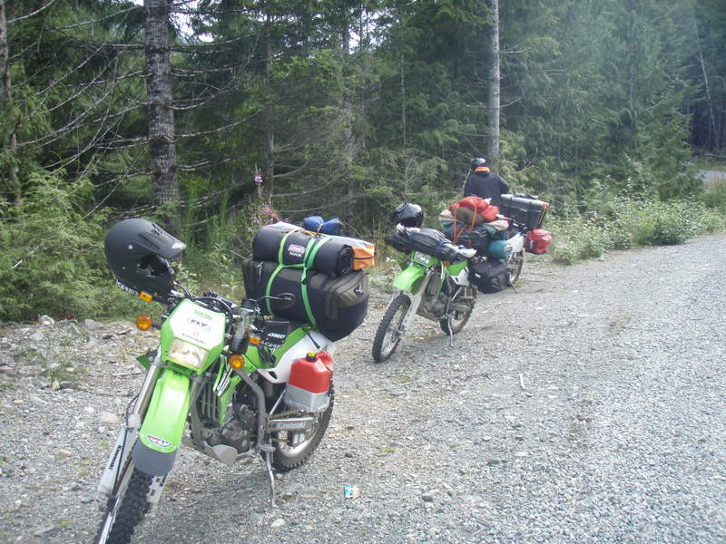

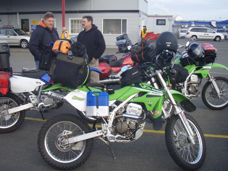

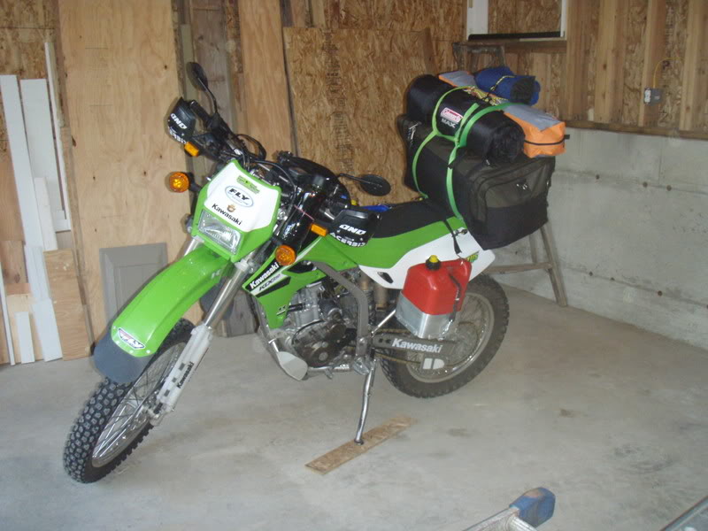

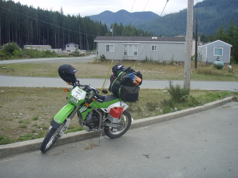

Hey Tony. Weak sub frame? Tell that to my bike. 75 lbs for 700 miles on some of Canada's roughest roads.
