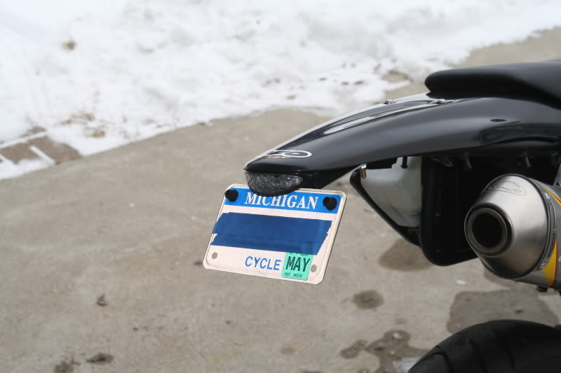

Does anyone know if the rear fender from a 2006 will bolt onto the 2009?
I would like to install the Acerbis rear tail light to get all that junk out from underneath the fender.
To get a setup like this.

option 1
remove the metal plate holder...cut everything off leaving only enough fender to bolt on the license plate...
option 2
buy a fender eliminator for a 2009+
Kawasaki KLX250S & SF DRC Edge2 Red LED Tail Light w Bracket / Fender Eliminator on eBay!

The goal is to get all of that on top of the fender. Either one of the options leave it exposed to getting smashed in an off road wheelie when you go off the back of the bike. For me, usually happens on a really steep up hill climb with a lip at the top.

in that case...remove the two-piece rear plastic and rear fender...get this New Custom Motorcycle LED Brake Tail Light with Turn Signals Blinkers Integrated | eBay , get a kxf250 rear fender, trim it to fit to fit the lines of the side rear fender and saddle, and mount it...if you want the tail and lights to sit even deeper..you'll need to cut the two rear frame tubes....
it should look like this in the end
if you want to try it...i have a partially trimmed rear kxf250 fender and a brand new rear tail light with integrated blinkers (as pictured in ebay link)...you can have it all for $40...after i found out integrated tail lights were illegal in california..i didn't use it...and went back to my stock fender...this when i had the fender on my bike...

Thank you for the offer. Let me think about it. Is the fender black or green?
A few of the guys I ride with have a similar setup and they often are zip tying the plate back on after a get off. That's why I'm trying to get it on top of the fender.
