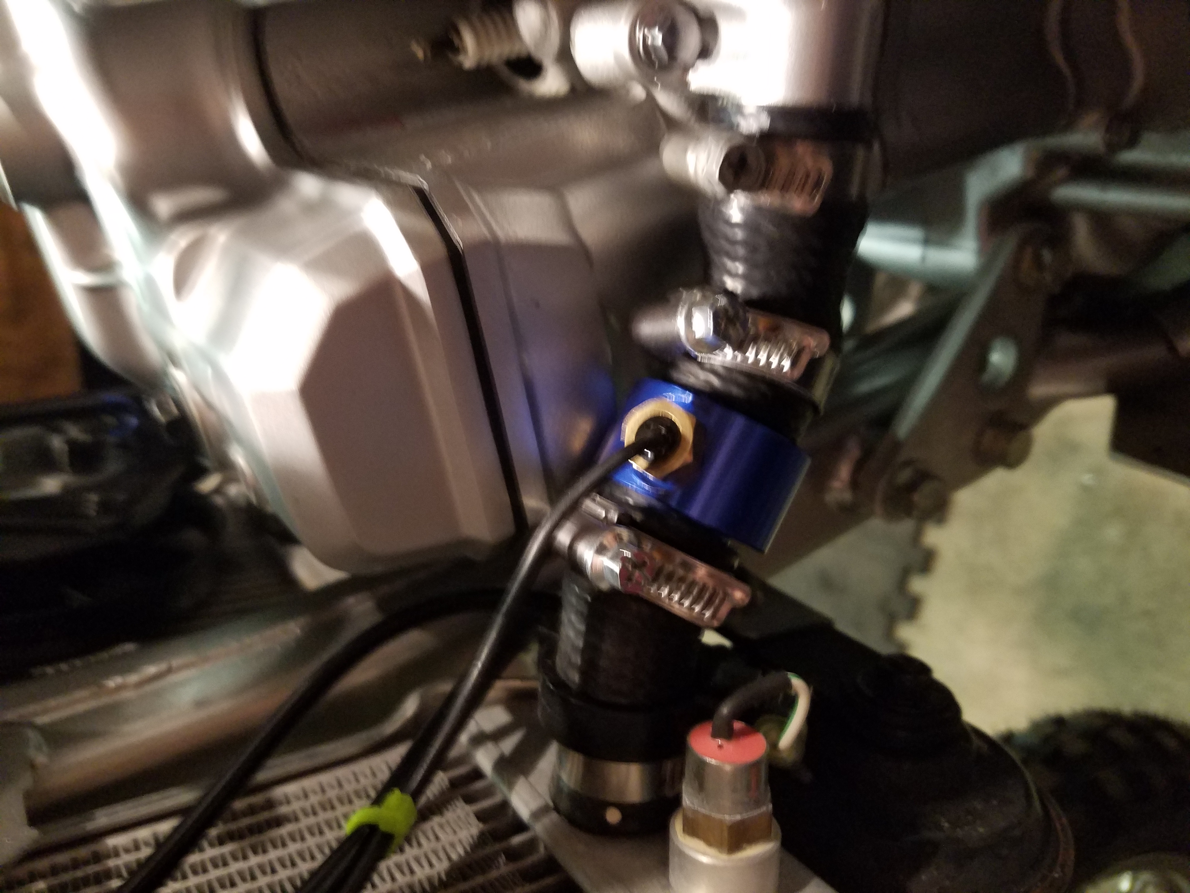

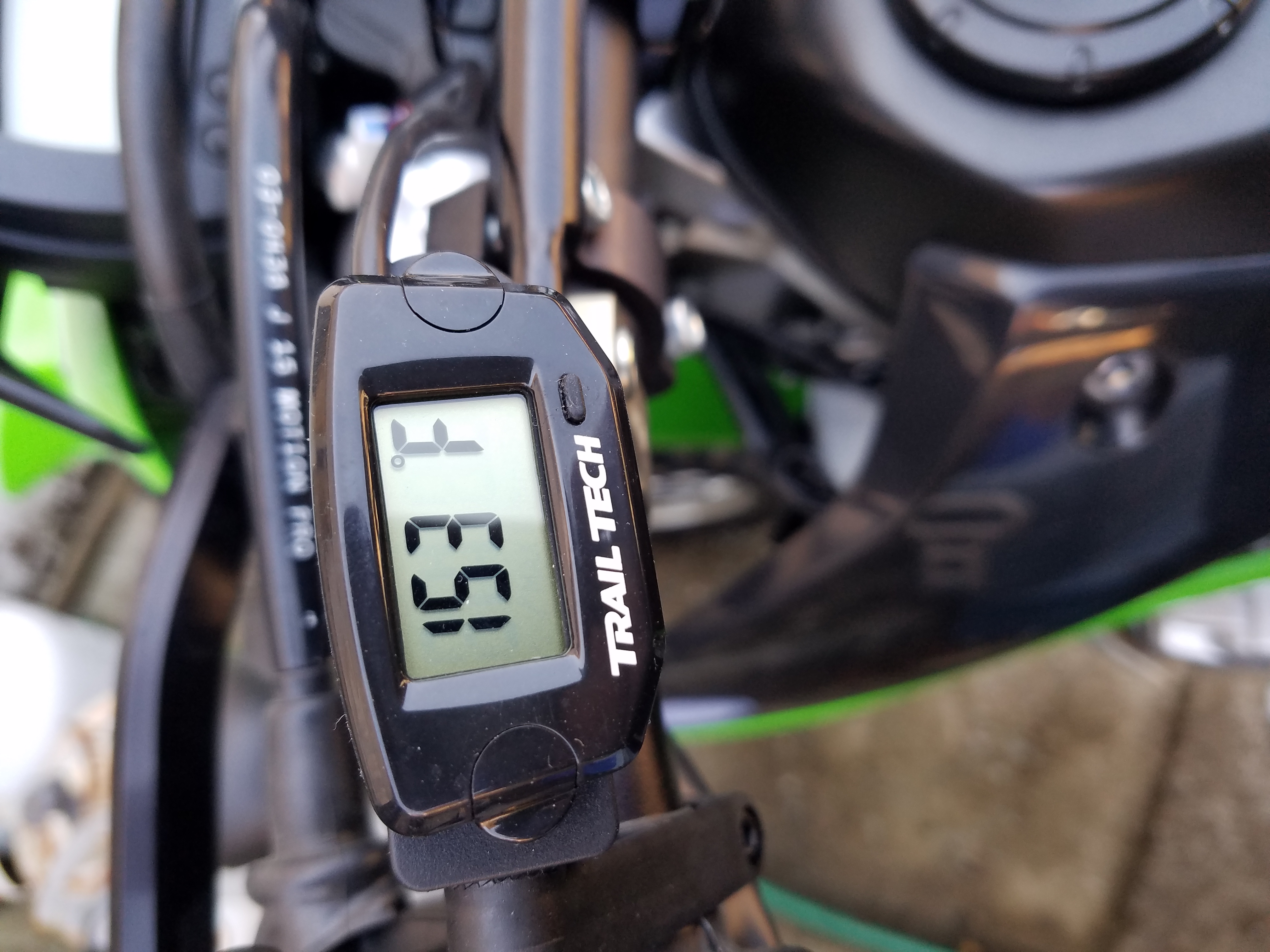

I don't have a answer for the OP but can add some info.
My klx turns the fan on @ 205 and off @ 196. Riding down the road it runs 153 all day long. Trails about 165 to 180. The only way I can cycle the fan is in neutral holding the rpms up. Other then that it's never on. This is with a big bore kit.

One of my best mods.
