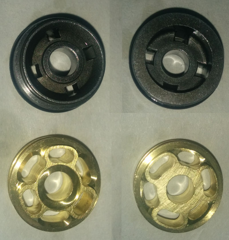

This is the gold valve they gave me, Does anyone think it is the same as the one they fitted?
https://www.kawasakiforums.com/forum...-1287-4208.jpg
https://www.kawasakiforums.com/forum...-1282-4206.jpg

Nope.. definitely different than mine. Attached is a picture from one of Arctra's posts showing his FMGV 2040 parts. My FMGV-2040 parts differed just a bit, as three of the larger oval ports were cross-divided on the short axis... turning one large oval port into two smaller ports.. if that makes sense. The divider was pretty thin, so not much volume difference between one large part and two smaller ports. All the ports were straight through..no deflection like on the model you have.
