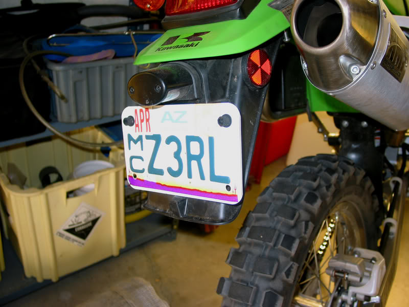

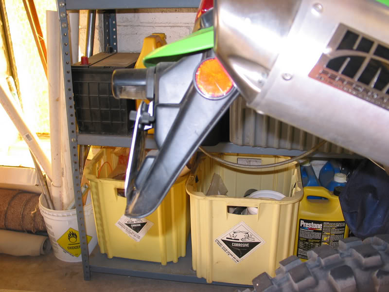

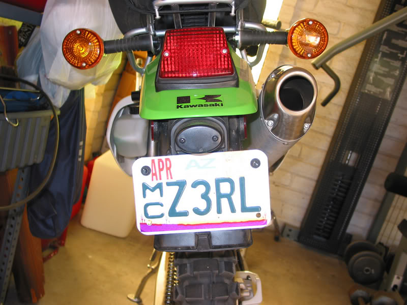

I wanted to raise the license plate without spending any money and still make it look stock - how's this? I removed the license plate and bracket, reversed the bracket, removed the reflector, drilled two 3/8" holes and bolted the whole thing back together. It raised the license plate by almost four inches - maybe not enough for KawiKathy, but it works for me

Looks good. I did the same thing to my bike, but cut the black plastic up a little. (cut off from right above where the old plate use to mount) ThenI added some heat to the edges and bottomto give it a more finished look. I'll take some pics of it later.

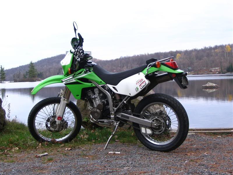

It's dark in the garage so here's the only one I have. You can see how I had to trim the "ears" on the plate, I figured it would be best to remove them instead of letting it rip farther.

Looks fine! I do like your black seat cover too! I bought one a while back and still haven't put in on.
