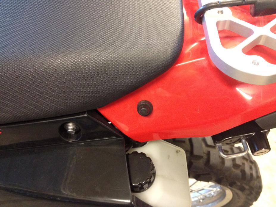

I finally found a water-proof line interrupter for my USB port. Install was a breeze. It's a simple on/off push button with a rubber cover and sealed underside.
Attached Thumbnails Questions on battery charging and cut-off switch-photo-1.jpg   Questions on battery charging and cut-off switch-photo-2.jpg
