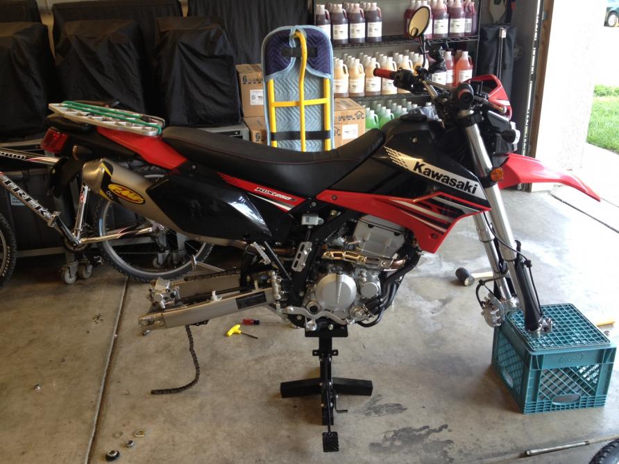

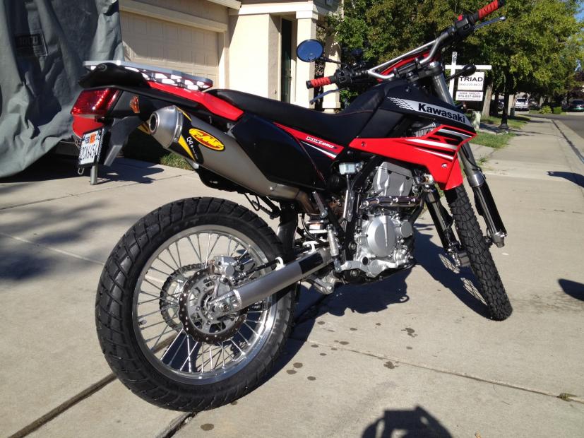

I got both tires on today. I really like the look. It still looks like a dirt bike but with better street tires. It'll take a week to break them in before I can get real feel for them. I did notice the smoother ride on my test run so that's good.

Just like mine...what size did you put on the rear?
You will like them..I do

I got a 90/90-21 and 120/80-18. I think I'll like them too.
