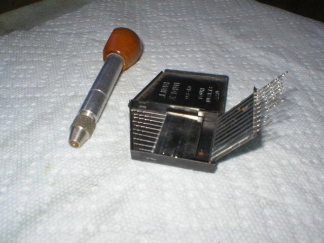

You can spin the bit in your hands or put it in a small chuck and not use a power tool to minimize the chance that you over do it.

The pot metal of the carb body is on the other side, but it's a decently large cavity, and you'll easily feel and tell when the bit has gone through the brass jet. You'd have to get really crazy with the bit to do any damage. You're doing this with a small hand-held bit holder or even just a pair of vise grips will work. Don't put the bit in a motor driven drill.

What size is the jet before drilling? If you can drill it out by hand it must be pretty close to .018

It's a .016" or so. It's like other jets you change. The physical size of the steps are quite small.

But seriously, I'm not saying that one might not be able to extract a starter jet with heat or such in a very careful manner...but...I don't think I've seen a source for starter jets. I think the reason they are pressed in is because this usually isn't an issue. Manufacturers can even be a little rich on the starter circuit since it only functions when the choke is operated. In the case of the KLX, they just spec'd one that's on the lean side. I actually drilled mine out to .020", but I can't leave the choke on for more than a few seconds. It's not a problem, but I could tell I didn't have to go that large. Just 1 or 2 thousandths is all that's needed to get the needed amount of fuel for a fast cold start. You'd think such a small increase wouldn't give this result, but it does it in spades. Over many years at a shop I worked at through the '70's and 80's, we fixed quite a few incalcitrant cold start bikes in this manner. It's a real PITA having a bike that doesn't want to start in cooler weather. This is an easy fix.
