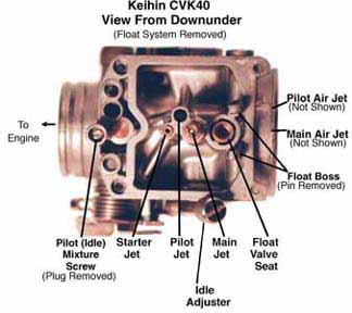

Mike, the mention of the KACR compression release is a not a common problem, and I seriously doubt that will be your problem, though nothing is impossible. A too small brass starter jet in the float bowl area of the carb has been the common problem for cold starting on these bikes, and it's happened before on other bikes with similar starter jet designs. When I worked at a Kawasaki dealership in the past, we had a run of similar problems with the late 70's KZ650's. Unfortunately we had to drill 4 starter jets in that case.
If you're lucky enough to get to talk to a tech or mechanic that knows something beyond what's in an instruction manual, just mention that many others have drilled the starter jet out to .018" on bikes that have had similar cold start problems with great success. Most bike shops have an index drill set for carb jet drilling and other small drilling jobs that will have a .018" bit. This is neither rocket science nor brain surgery. The starter jet is a pressed in unit, so you can't just replace the jet with a larger one like many of the other jets in carbs. Drilling it out affects no other operation of the carb except when the choke is used, so you're not burning a serious bridge here. Here's a pic.

Having the picture is great. Now I know what to look for, I didn't think the KACR compression release, Would be the problem either, I'll give them one day then I'll either drill the jet myself or pay the $60.00, The Dealer said he would charge, I just don't want to mess up the Warranty. My Dad was a machinist so I'm sure he has a .018 drill bit.
