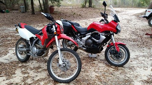

LOL... my father is one of those, can't trust him with a hammer. My mother on the other hand, could have built a house with a pair of pliers and a pocket knife.
I've got a set of Race Tech forks springs on the way so she won't dive so hard on the front end, and an old style shift star on the bench to try and head off any future shifting issues before they happen.
I just got back from a running her around the back-forty a bit and she's running good. A slight hesitation sometimes around 5000rpm so I may do the 'ground mod' and see if that clears it up.
Once I get my Christmas bills under control, I'll throw on some ***** and rim locks and see how long it takes to send myself to the ER

Wow! It sounds like the '09 is definitely in better hands now! Have fun with it!
TC
***Oh, you might see if the PO did anything with the jetting when they added the FMF exhaust, that might be your 5k issue???

Yep, very familiar with Thor. Force is their tool..
Also, take care with the ER trips...we don't bounce as well as we used to. Looks great.
