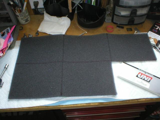

Searching through the Tucker/Rocky catalog online, I noticed that Uni makes various levels of flat, bulk filter material, and it's not expensive. I chose the coarse size, as it what they use in their outer filter in their two-piece filter...and this is a pre-filter only. This material is totally washable and reuseable.

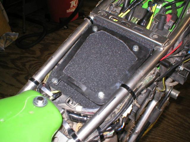

The size of the material was big enough to make 6 pre-filters. It was easy to install under the airbox top. I left it dry for this application, and I'll see how it works. I have a 2-piece Uni filter and a Twin-Air filter for the bike...the Twin-Air is under the pre-filter right now. I'm going to Moab in a few days, and I'll see how this works. It obviously flows more than enough air for the existing setup, so it's not acting as an obstruction. If I oiled it, I'm not sure how long it would last in dusty conditions, but probably not very long. It's a simple pre-filter, and that's all I'm looking for now.
