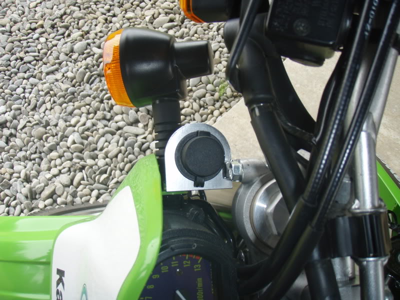

will have to take some new pics today when i get home and post...maybe i'll look for other places i can mount this power socket and have it little more stealth...i have another fresh front left plastic panel, so i didn't mind drilling an inch hole on this old plastic panel i had as a trial (the pictured panel has some damage on the lower left side)...

what brand is that power socket?...the one problem i had with having a heavy duty rubber cap is that it just dangles and flaps when left open during a ride (better to just put it in my pocket)....i notice your power socket has a solid cap and metal hinge....
i think i found one similar...$24... http://easternbeaver.com/Main/Produc...cket_kits.html
Originally Posted by Ranger Ron
There are lots of ways to add accessory sockets. I use Powerlet sockets for all my bike accessory equipment (PWM heated gear controllers, tire pump, Battery Tender, etc.).
My Powerlet connector is mounted here:
It looks like it sticks out pretty far, but it actually is tucked in well behind the shroud and below the rack tube.
Ron
i think i found one similar...$24... Power Socket Wiring Kits for Motorcycles, cheap worldwide shipping.
It's a Powerlet. It looks like that is what Eastern Beaver is using in their kit.
Powerlet Products - Rugged power outlets, cables and electronics
Ron

Hmmmmm I would worry about anything plugged in flapping in the wind, or worst yet getting ripped out by branches. I mounted mine up by the headlight. I bought a CB antenna bracket and installed it under a bolt up there.

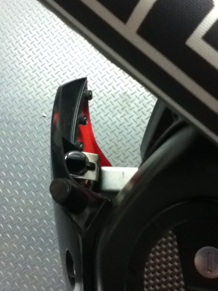

I think it was $12 at WalMart. Good quality socket with rubber weather plug. No rust going on 2 yrs now. Used factory bolt from the corner of the rad. Wired direct to the battery with a waterproof inline fuse also from Walmart and I put in a switch through the plastic rad shroud. It has an l.e.d. light so I know when it's on. I can use the switch with my Garmin GPS to turn it on and shut it off without using the switch on the GPS. I have the Garmin inside a waterproof soft case and the switch isn't easily accessible without unzipping it, so with the 12V socket on a switch, I find it's much better.
