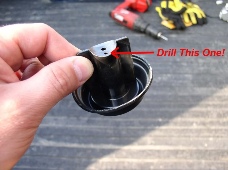

which plug on the carb do i drill out to access the fuel mixture screw? there are two side by side. one on a post and one that is flush mounted in the carb. the flush mount one looks brass.

The one in the tube/post, closest to the front of the carb.
I just checked.

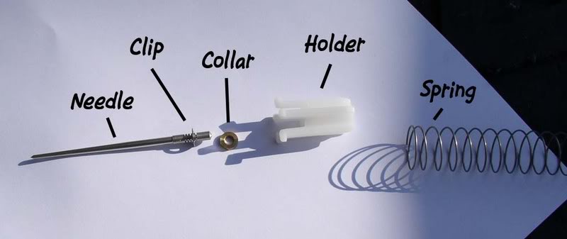

dont have a pic of exactly what you are asking for....

I ran into the same question. The plug you want to drill out is the silver color one, not the brass one. I got about half way through the brass one when I realized something wasn't right! Fortunately I didn't go all the way through.

This one
Full article here http://hmfracing.com/forums/showthre...?t=1617&page=2

Nice cover barbz. I normally just use a center punch or a small pin punch. The cap is so soft you can just punch a hole in the soft cap and flip it right out. I was always nervous on using a drill and going oops, just dinged up the head on that screw.
