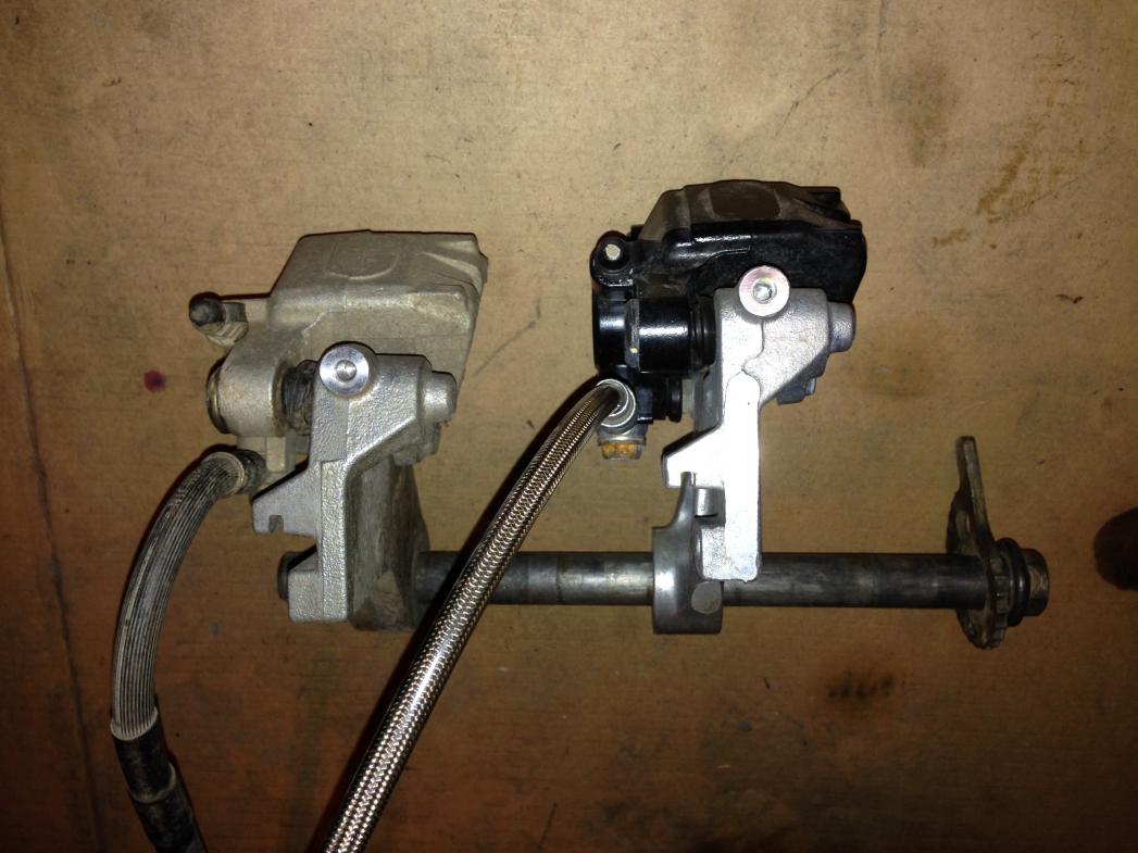

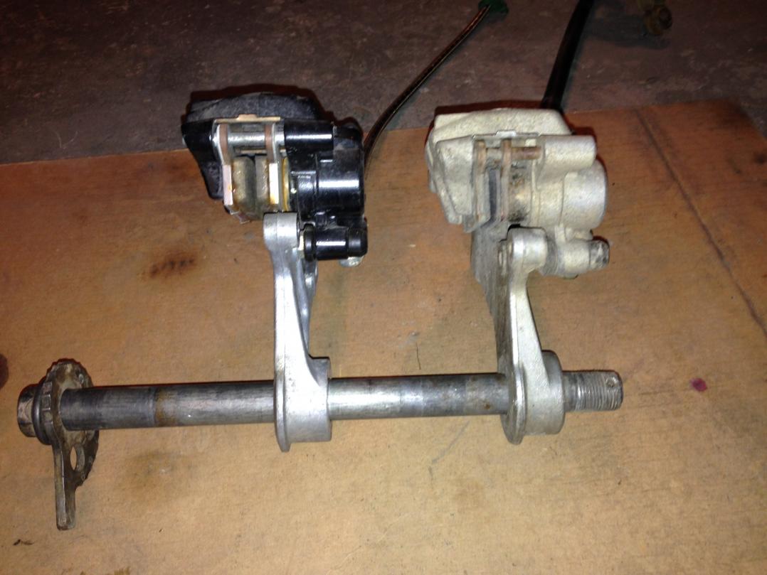

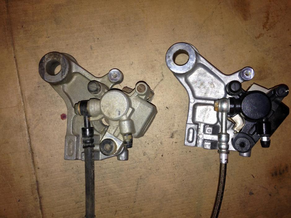

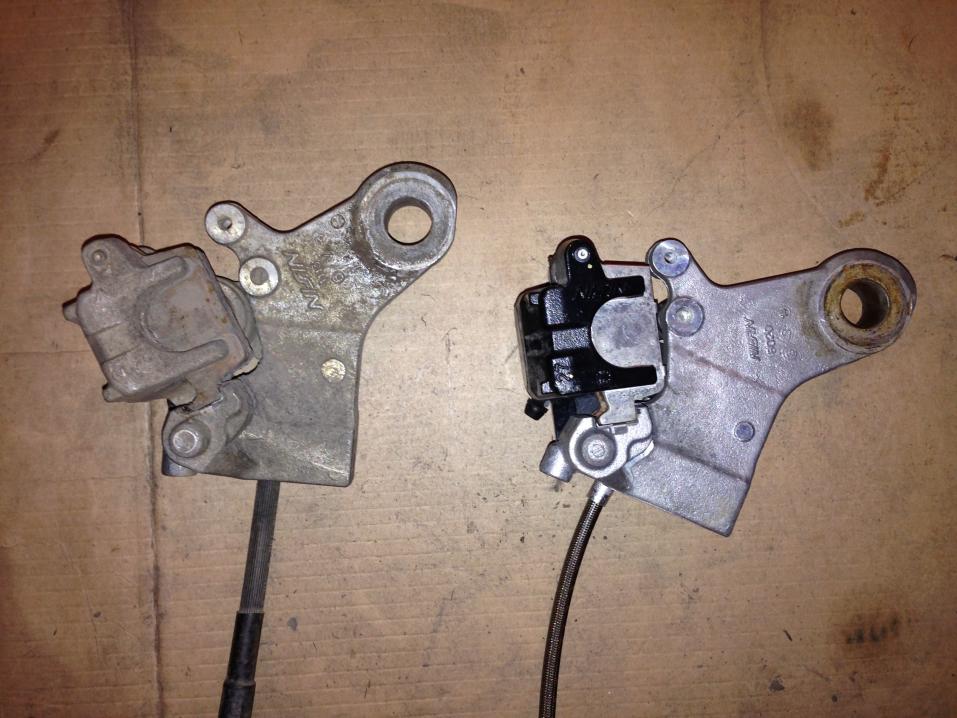

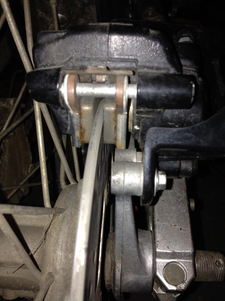

Here's some side by side picture, the black one is from 2009 and the silver one is from 2007.
They are almost the same but the 07 need the 220mm disc brake rotor and the 2009 need the 240mm disc brake rotor.
You can see on the last picture the 2009 brake pad not well align with the 2007 220mm disc brake rotor.
I don't have the picture but the 240mm disc is a direct bolt on the 2007 wheel and it aligns perfectly with the pad.
