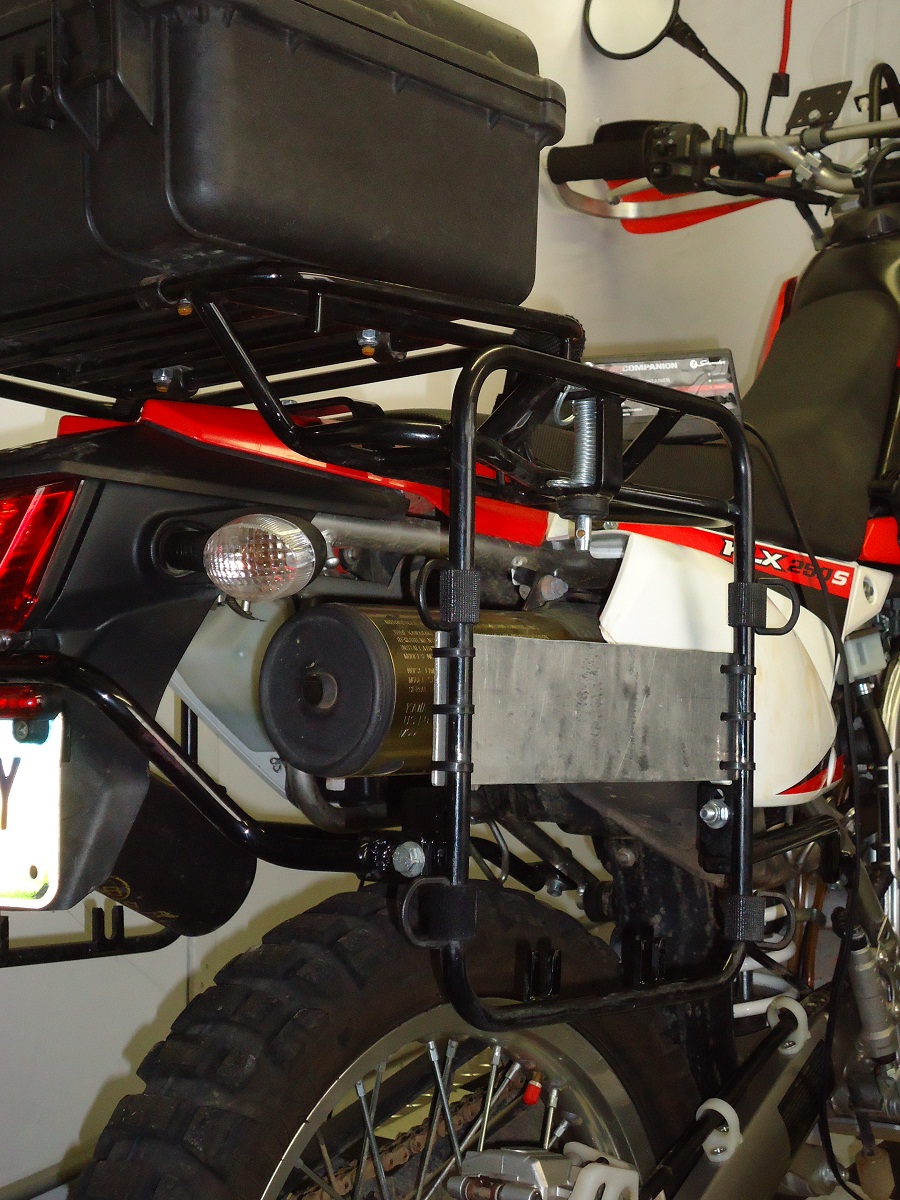

Old Jan 13, 2013 | 05:09 PM
DYNOBOB's Avatar
Joined: Sep 2011
Posts: 304
From: Cincinnati, OH

Thanks Dynobob! I will have to figure something out for the passenger foot peg.
