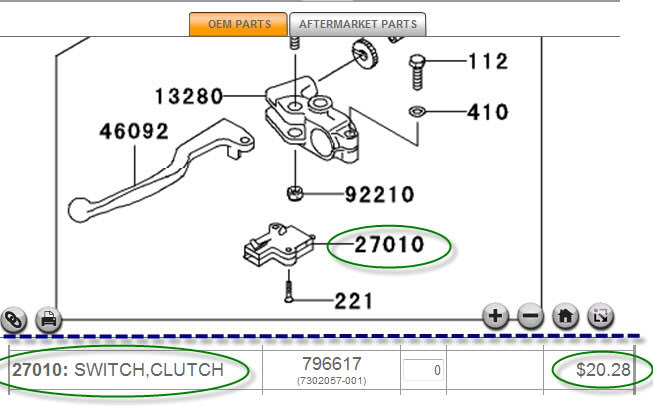

Can anybody convince me I should spend the $21 + S&H to replace this part?
Here are some pics. Unless convinced otherwise. I think I short the circuit and pull in the clutch.

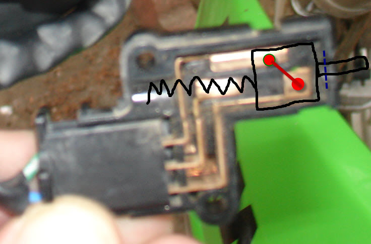

Ok one more post. Just incase this happens to somebody else.
The black is the sliding contact. Spring on the left and pin on the right. My pin broke at the blue dottted line. The clutch lever will push the pin in when the lever is released and make the red contacts slide off the Brass and break the short. That will not allow the bike to start in gear if the clutch is not pulled. If your pin breaks. Just be sure that the slide is all the way forward. This will make the bike think that the clutch lever is always being pulled in.
Please comment if anyone thinks this is bad.
Thanks
Thanks
