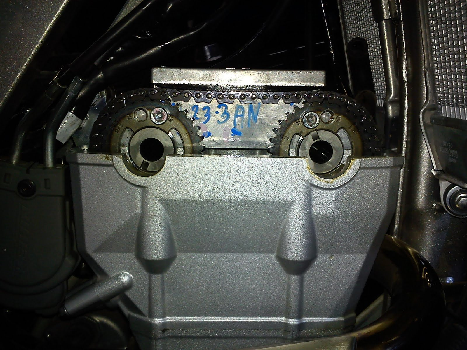

Here is the pic I used for verification:
Cam Mod

That pic is not accurate. The indexing of the timing marks relationship to a tooth, on the gears, changes from the top pic (stock) to the MCM pic.. More importantly, the tooth count relationship to the head casting surface , as depicted in the "cam mod" pic is wrong, The pic seems to show a 3 tooth chain mod - when you count the teeth.. Since MCM documentation is clear that you move each cam two links, the irregularity in the pic is likely not going to cause peeps to move their cams 3 links unless an owner uses that pic as "gospel" and does "whatever it takes" to match that pic..
If you did move the cams /cam gears 3 chain links instead of 2, your cams are now 1/2 tooth "wrong" - in which case your intake is retarded and your exhaust is advanced compared to stock timing - which will definitely serve to increase power in only the very top end and kill power everywhere else..
Writing instructions is an art form.. I can't understand the phrase "align camshaft hole and mount" - this is complete gibberish to me..
I have crudely added new timing index marks and the cylinder casting surface to correctly show a two tooth mod -

Thanks for taking the time to spot the errors. I think I may have been guilty of matching the pic... Certainly enough doubt in my mind that its wrong, so I'll take a look at the weekend.
I think I'll photograph it as it is now, revert to stock, then reapply the mod following the instructions rather than that pic. Be interesting to see if its different :-)
Know what you mean about writing instructions being an art form, but for what its worth your description in your previous post "The end result of the MCM is that both cams are rotated toward eachother the equivalent of 1/2 tooth" nailed it for me!

Here is a good pic of the final "product" - I have edited it to help make this as clear as possible..
This photo is from KLX678 's tutorial on the MCM. See it from his link on his signature line in his post above..
Sidebar: Throughout many years, the MCM was considered experimental because it did not "seem to work" for some and no one had dyno tested it.. This is likely one reason why it didn't "work" sometimes - going 3 links instead of two.. But those days are long gone - with my dyno testing showing proof of effectiveness, the MCM effectiveness cannot be debated..

I personally like to look at the "keyways" in the ends of the cams, comparing before and after as a sanity check. Too easy to miscount teeth and get confused but those keyways are a solid reference.

I have re-edited the photo numerous times trying to get more succinct in relaying the pertinent information..
Any remaining questions should be asked here so I can edit the photo more if need be..
