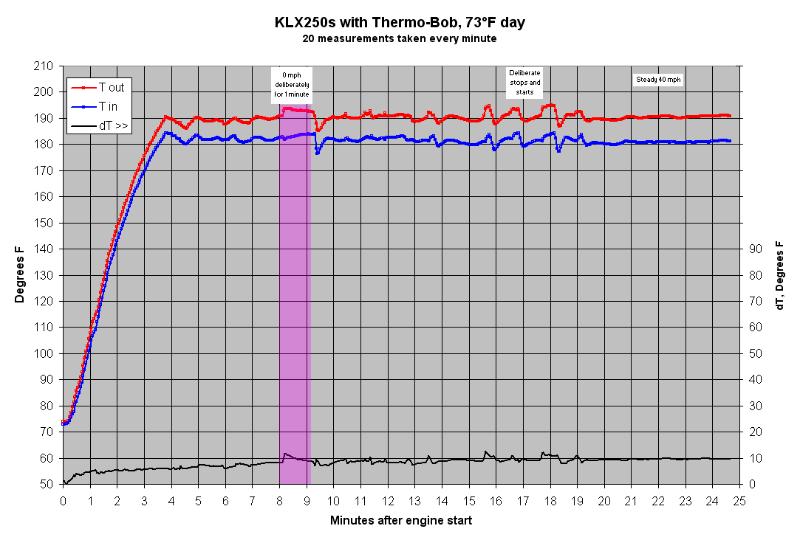

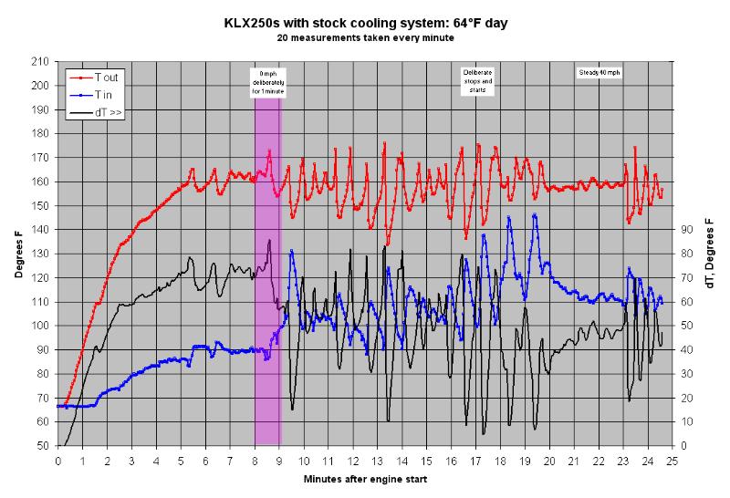

Here is the data. As you'll see, it's even wilder than the 650. I set up a repeatable 25-minute ride from the house that included a relatively steady 40 mph ride for about 8 minutes, a deliberate stop of a little over 1 minute, some stop and go, then a return home with a section of stable 40 mph again. Temperatures were measured every 3 seconds on the inlet coolant line, as well as the exit from the engine - just like the 650 testing at the site in my signature below. The 25-minute ride length with 20 data points per minute is my present recording limit; 500 data points per thermocouple is all I can record - but it clearly was long enough to show the trends.
The first plot is "before" - the bike was stock with it's 160° F stat trying to regulate engine exit temperature at 160° F. To get a feel for the significance of the swings, 13 minutes into the test I saw coolant exiting the engine at 176°F... and six seconds later it was 133°F. Wow!
The second plot is "after" with the Thermo-Bob regulating the engine inlet temperature (this is a departure from the 650 design). Since we're shooting for an exit temperature of 190° F to 200° F, I use a 180° F 'stat to regulate the inlet temp at 180° F. This results in exit temps being stable at ~190° F. The largest swing noted in that test was from 195°F to 187°F over a 12 second timeframe in minute 18 of the test.
It took a number of revisions to the system layout and sizing to get the 'after' version to be this stable. By the time that final test was ready to be conducted, I couldn't get a 64° F morning to complete that final test so you'll notice the ambient temperature was about 10° warmer. Since the bike was able to hold the temps on the thermostat, this did not affect the results other than shortening the warm-up time by about a half-minute.
