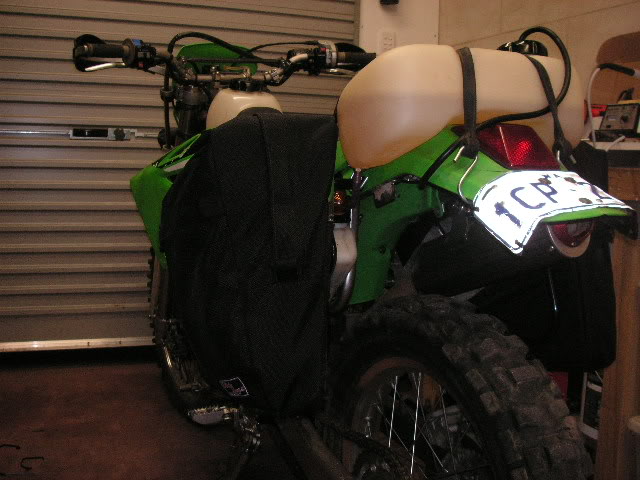

Great thread.
Cruise control on a KLX.
My contributions would be the Nomad rear fender aux fuel tank.

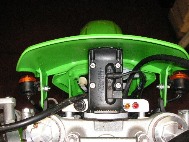

Replaced the stock ignition switch and dial assembly with a toggle switch, cradle for a Zumo GPS and 2 temp warning lamps.

And added a small circuit enabling me to leave the headlight off until I wanted it on without adding another switch.
