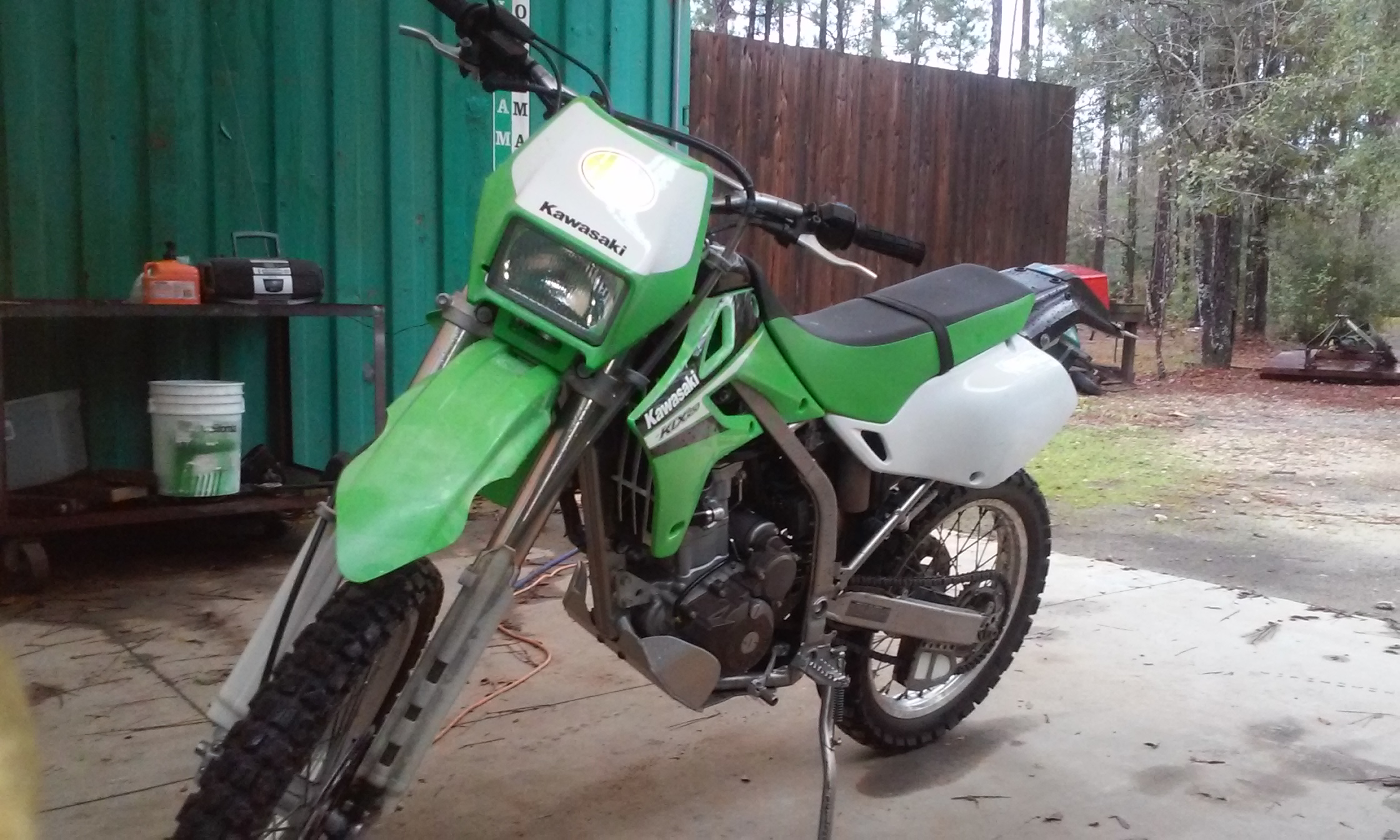

Well, half a day, a tank of gas, and a severe thunderstorm later, the bike is safely at my house. I followed the advice posted in this thread, checked the bike over--fluids OK, carb is indeed showing signs of sloppy seal work, bike turning over but not starting--and made a low offer. He was happy to have some cash, and me without mine.

SHE LIVES!!! While I was at work, my friend tinkered around with it for 30 minutes, found the air filter to be filthy and falling apart, the brake fluid to be black (wtf), and flushed the carb bowl. Bang, bang--fired right up!
It's a little stubborn with the cold start, wants to cut out. We set the rpm's up a bit and that seems to work. I'm going to order an air filter, new levers, and hit it with the pilot jet mod.

Congratulations on the repair and getting her fired up. The brake fluid was likely original and being dark is no surprise.

The "pilot jet" mod for easier starting is actually the "enricher/choke jet" mod. Find a 0.018" drill bit at a hobby store. It removes just the smallest amount of material from the enricher jet. The bit almost fits in the jet before drilling out. One owner went to a 0.18" drill bit. Don't do that! This one is drilled because it is pressed in and cannot be removed and replaced.
Pilot jets are difficult to clean properly. I'd be tempted just to purchase a brand new pilot jet for a few bucks and toss the old one. This may also help it idle better at startup. While the carb is off, remove the EPA cover from the fuel screw so it can be adjusted if needed (many need backed out a little to richen up a bit).

roger that on the drill bit, fuel screw, and handguards. I want factory length levers right now, any sites to recommend buying from for fast shipping? I'll have to search for the proper length handguards to match, as well. Any particular air filter that's a well-kept secret?
