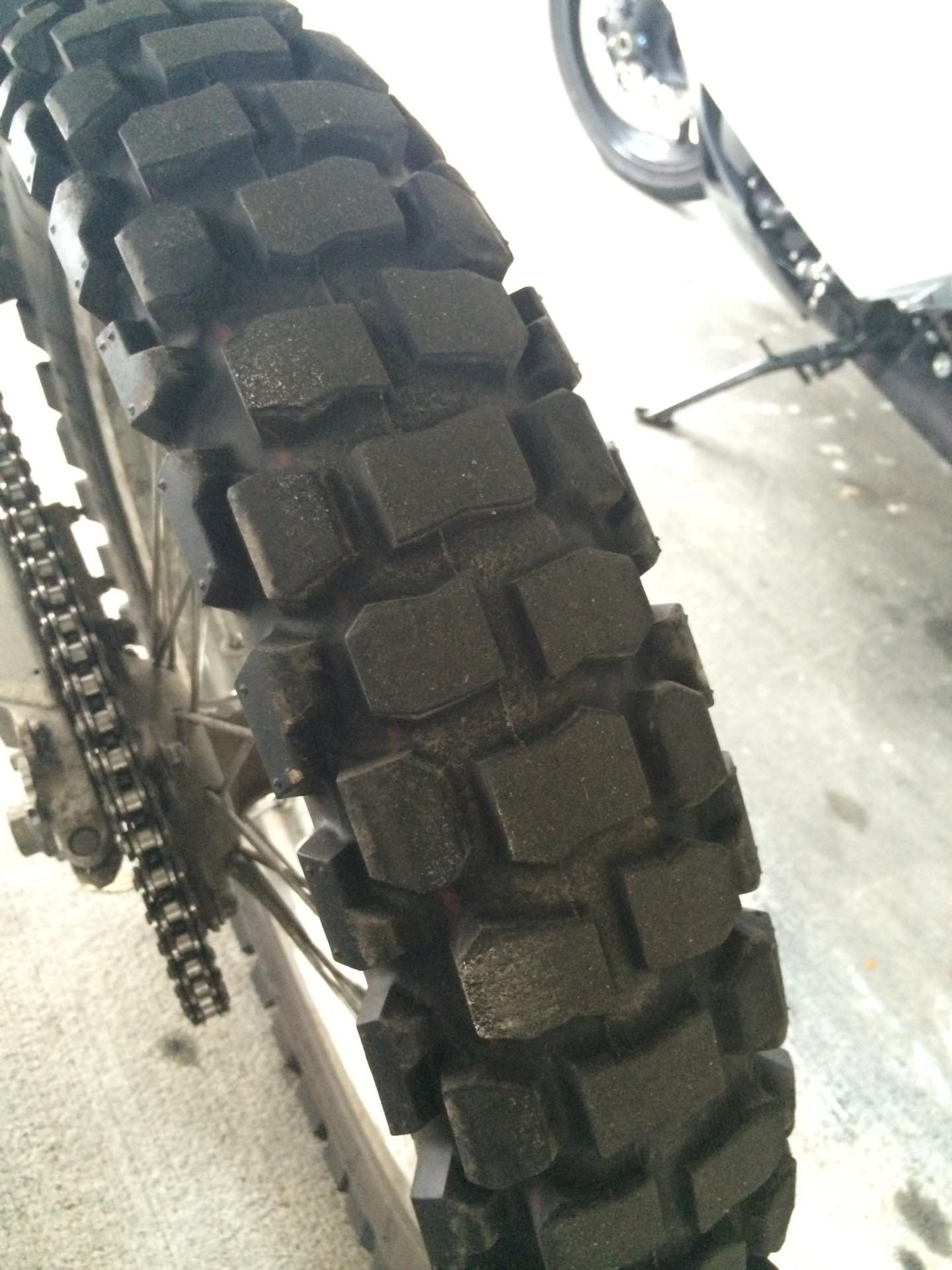

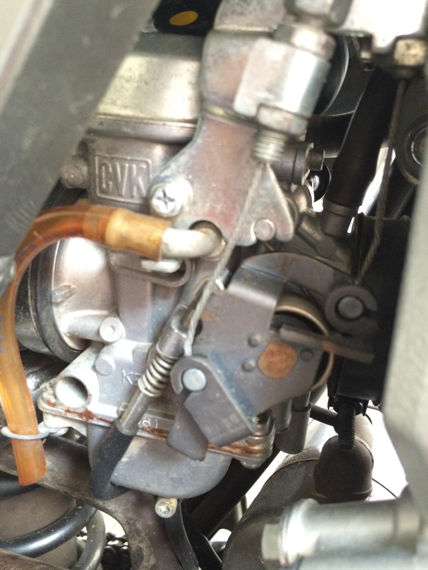

Any bad noises when its turning over?

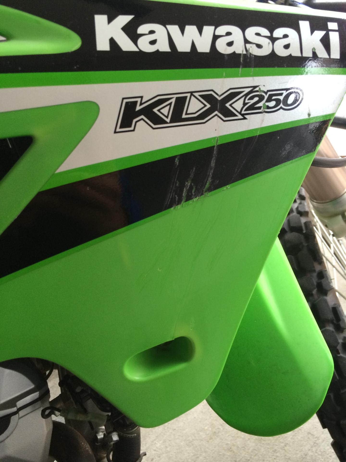

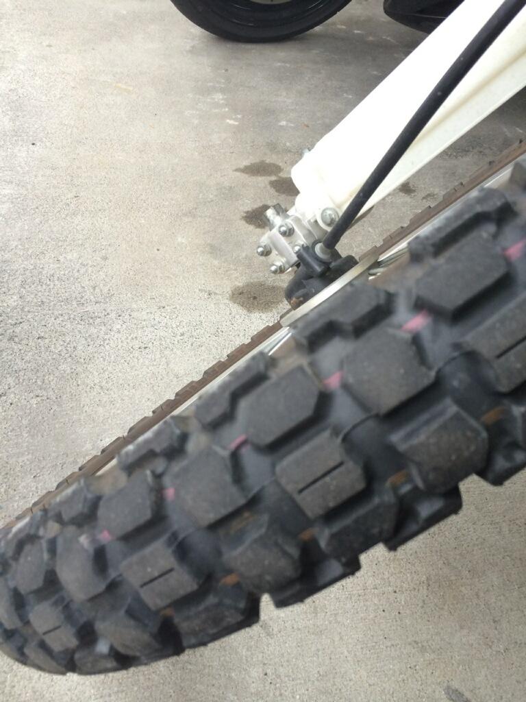

I don't like the looks of the carb corrosion. Tires look okay. The plastic rash isn't unexpected for a dual sport.

Yes, the corrosion at the seal is troubling. Is it an indication of much worse condition inside? Bad gas?
There were no clanking noises or anything disturbing--sounded clean.

I've tore apart one other carb that looked like that and it was a mess inside.
However, if he's used it as a daily rider, then it shouldn't be that bad inside. It could certainly be an indicator of a dirty carb that needs cleaned and that caused a non-running condition.

Can't tell if that is corrosion on the carb, or someone tried to make a carb bowl gasket out of orange permatex ?
That's what it looks like to me. Should be an easy fix. Tell the owner you think the crank is done and lowball him with cash in hand. Hold that poker face

... or someone tried to make a carb bowl gasket out of orange permatex ?
That's what I think. So maybe some of that got where it shouldn't have ...
