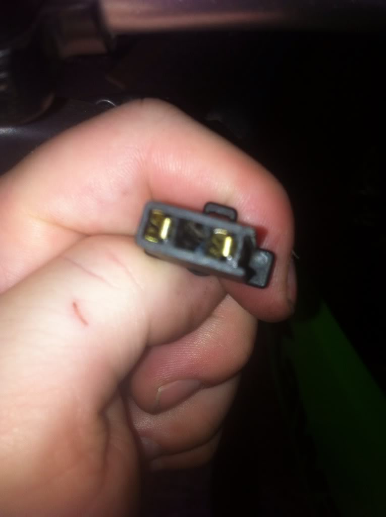

Will the piece of solid aluminium wire work on the clutch switch bypass? Its 1.5mm.
And you just force it in here..
And cable tie it up?
Seems easy lol, i will give it a go tomorrow.

Yeah that worked, just took it for a spin and got a 15mph increase top end and the acceleration is a little better in 4th 5th and 6th, well worth doing for peanuts.

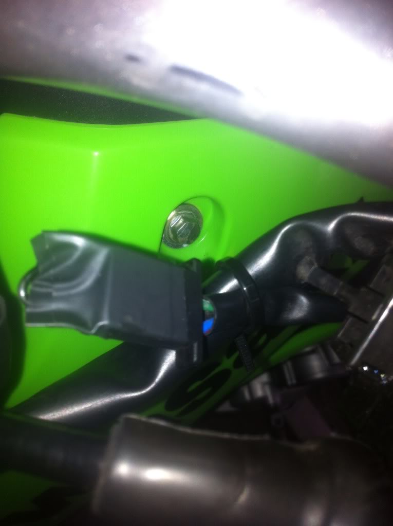

How did you hide/ protect your clutch switch? I cable tied it and put a bit of tape around it.
Not very weather proof though is it? Any suggestions?

As long as the bit of copper wire is shoved in hard enough not to fall out! I had some electrical tape over the loop of wire but it fell off almost a year ago & I just left it plugged in & open to the elements!! Don't think it really matters once it's neatly cable tired away. IMHO.

I used a few strands of bare copper wire (from a piece of 15/0.1 cable). Position them in the connector, the same way as for the 1.5mm wire, then fit the connector as normal. Once the two halves are plugged together it jams the thin copper wire in place and shorts the switch. Looks like standard!
There is almost zero current flow (I measured it) so even one tiny strand of wire is sufficient.
