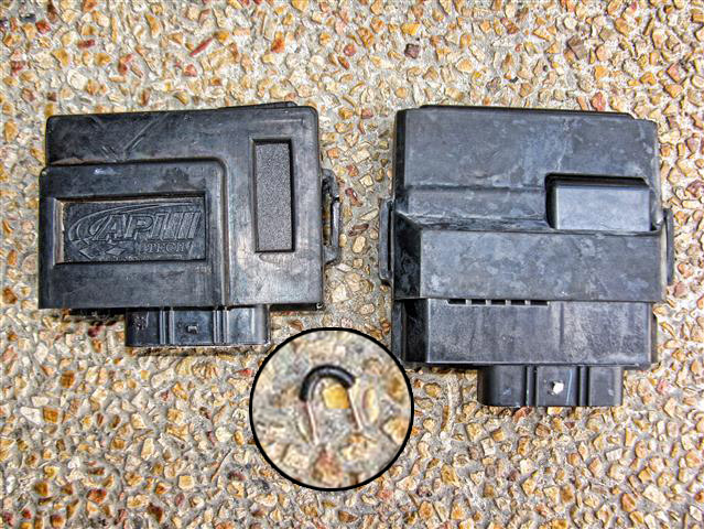

One more question, when you disable the clutch switch what sort of wire did you use and where do you get it from? I read somewhere that someone used a paperclip but this doesnt seem sturdy. Cheers

A 1.5 or a 2.0mm solid piece of wire bent into shape like the middle of the picture below:
Wedge the bent wire into the clutch connector block so it's not going to slip out & neatly cable tie it away. This mod will not hurt your bike!! From being restricted to 7,500rpm......It will let your bike rev to 10,000rpm in 4th, 5th & 6th gear by un-retarding your ignition timing to what is was made to be at the factory, before the EURO3 emission ***** got their hands on your bike!
