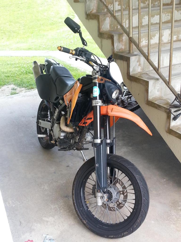

I have a set I'll be getting looking to unload in about two weeks.
They are dirty, I just bought this bike a couple days ago, so no pics of my own. Sizes for Dunlop are as follows, front : 17 in, 110 width rear: 17, 130 width
You can PM me if these are what your looking for, maybe we can agree on a trade?
