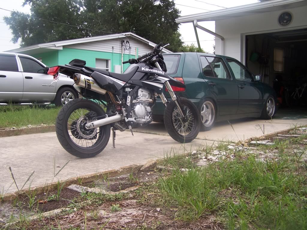

Hey guys been lurking for a month now. I suppose i should finally post up. I picked myself up a 09 sf a month ago. Brand spankin new.
Ive got a few questions for you jetting guru's. I recently put on a two bros slipon, air cleaner screen removed, smog delete, and removed the snorkel.
I put the DJ 2182 kit in. Needle set at 3 from the top. 128 main and 3 turns out on the mixture. My question is this. I get a slight miss every now and then only in 4th and higher gears. Also When cruising any rpm over 6k rpm in 6th gear it chugs and spits sometimes. What are these symptoms telling me? Mixture too rich? Maybe i should go a half turn in? Other then the very few chugs and spits it gives me the throttle response is awesome.
Thanks in advance for your guys help.
Mike

check the plug and see if your rich or lean. might need to put in a 1/2 turn in or so. nice bike and vdub too.
Thanks! The dub is for sale!!
