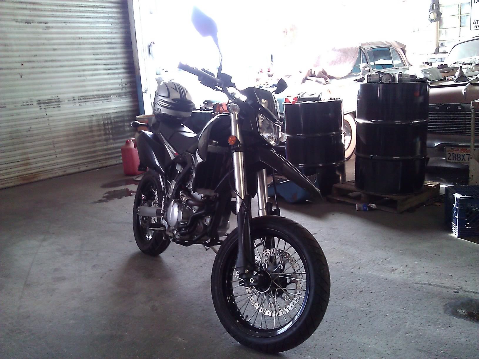

Just bought a like new klx 250sf today!!
I must say the low seat height and 3000$ price had me booked!!!

Heres a picture of the thing! It is really one of the happiest days of my life!
