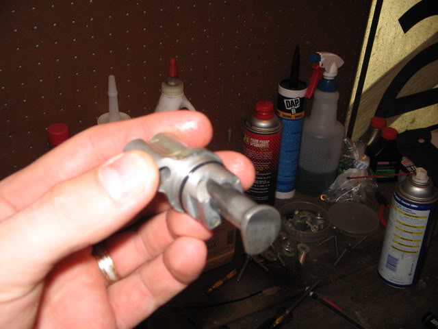

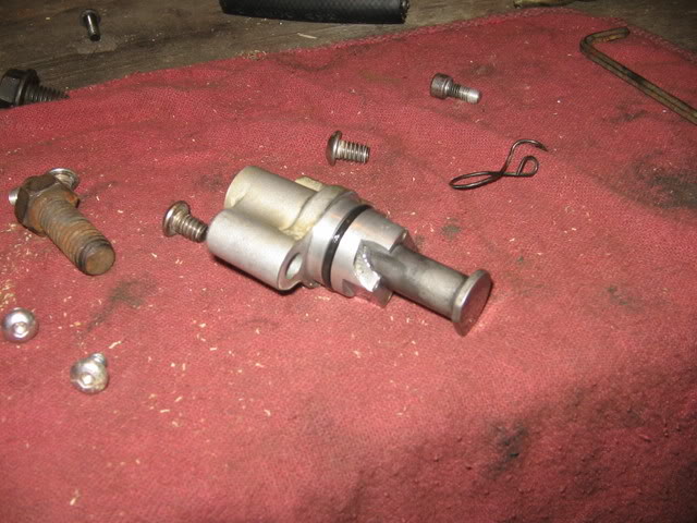

Ok guys, i was changing the oil and getting the bike ready for the weekend jamboree... well i noticed that under the cam chain tensioner was a little wet looking... so i decided to take the tensioner out and make sure the gasket is clean... look what i found....

Where's the missing chunk? [:-] You have the damnest luck, man.

thats the kicker...... im guessing its in the right side of the motor somewhere......

also the tensioner was fully extended too... so im thinking i need a new chain...

When you say fully extended, did you remove the center bolt first? Because if not, it would fully extend as you removed it. My main concern would be where that missing piece. Certainly it's within the right side cover somewhere but you wouldn't want that to get wedged or jammed in between some moving parts like the cam chain and sprocket, clutch, and so forth. What might be an hour job if you get it taken care of right now could turn into a big mess later if you let it go.

+1 What Brian said. I sure would be worried about that metal floating around in the motor.

Eric, I would definately have that replaced and have the chunk fished out. Murphys law will be in effect and you'll be 10 miles out on the trail, and the motor will lock up. I would put pressure on the dealer to do it asap since it is warranty work. Also, I may be paranoid, but someone from kawasaki could check out the forums and see the thread, and deny responsibility after the motor grenades on the group ride. I would do what no brakes said and call around to dealers till one you trust will commit to speedy service. Good luck Jeremy
