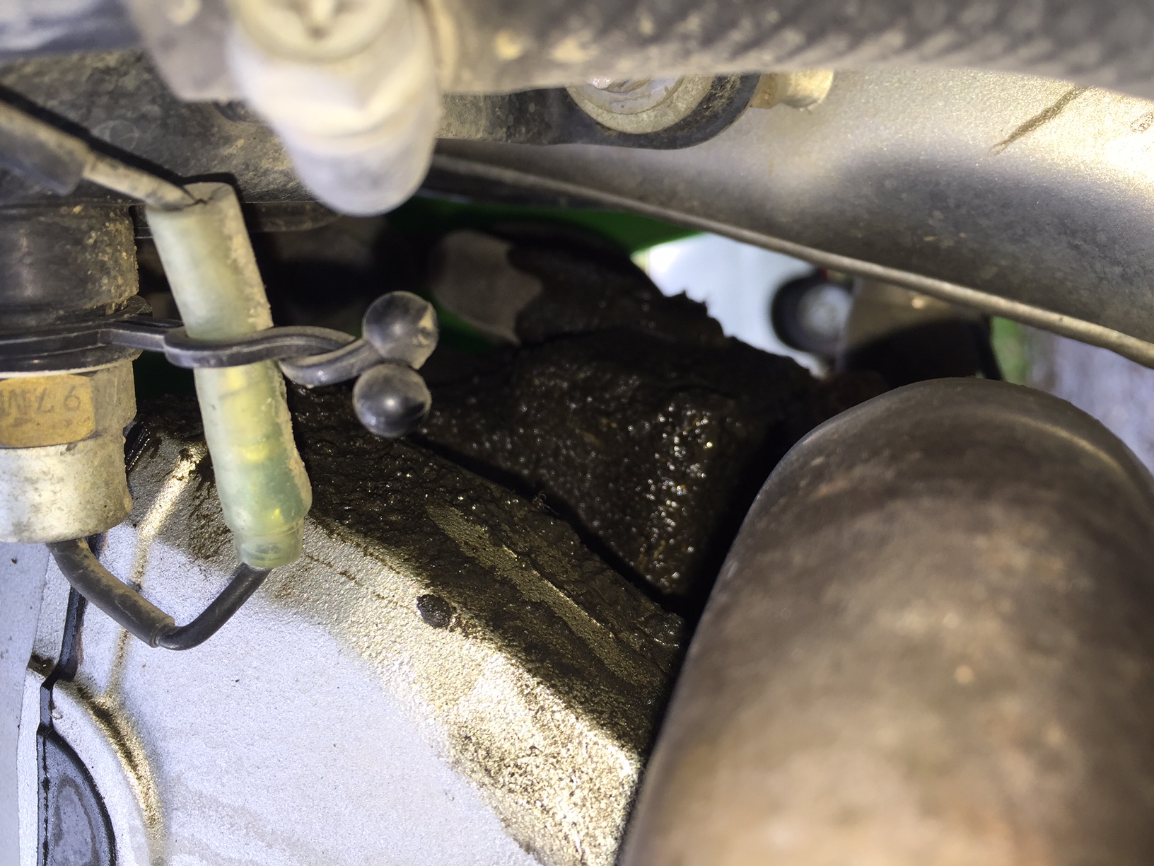

Found a nice 2006 KLX250s and thinking about grabbing it.
28K easy miles, looks new, 2 owners (older). Two issues I noticed:
1) Oil on the top front of the engine (head gasket?)
2) Loud clicking sound while running. Owner says it's from some kind of mechanical thing that needs adjusting that helps toss the oil up into the engine. Have no idea what the hell he's talking about. I'm guessing CCT?
I don't want either of thee to deter me if they are not difficult or expensive fixes - I've been riding a VFR800 for years and working on that thing is like working on a space shuttle so I'm not deterred by work but I'm not familiar with dirt bikes. He wants $1900 and comes with some extras.
I've attached a pic of the oil as well as a short video of the engine running for the clicking sound.

I have no real insight into the problems..but quickly thinking. A bad gasket and I didn't watch the movie but I'd say it was the cam chain clicking.

No doubt the leak is on the cam cover gasket. If a head gasket was bad you'd likely have milky oil from water in the oil since the actual pressurized fluid is the liquid cooling. Pressurized oil is carried by an external line, not through the head where it might leak, especially at the front. The gasket is known to shrink if taken out and left lying while doing valve shimming - like waiting for ordered shims. I put my cam cover back on with the bolts snugged up a bit when I wasn't actually doing the shim work, waiting for shims to show up, to keep the gasket in good condition.

If you are intent on getting the bike I'd clean off the oil and run it to see where it's coming from. Is the cover cracked? Is a bolt missing or loose? Is it coming from the gasket?

Also, no bike of mine would ever be run with crud like that on the top of the engine. So, it's not really a good sign of the character of the owner.
