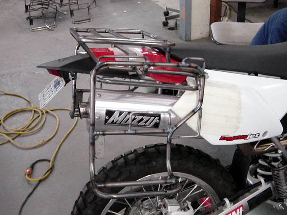

It looks like the bike you are working on for the Denali rack does not have a stock rear lights and blinkers. It also looks like it has an 09 Muzzy. Be aware that the stock blinkers do extend out to just over the end of the oval on the exhaust-before the little trumpet extendo thing at the end.
Also is this a permanent rack setup?

Any thoughts about running a a brace from the lower, foward part of the saddle bag frame to the passenger peg bolt? The rear sub isn't all that strong to start with, so bracing on any axis is a good thing.
All of our rack designs have mutiple mount locations. The picture is in process and does not have all parts fabricated yet.
All of our racks will be fabricated in mild steel. Other materials become too costly for this market.

looks like to bolts up to the stock gear bag holes, nice. i dont know if you notice me saying, but these bikes need rad hose guards pritty bad, any look into those. looks like you could bolt some sort of guard to the motor mount pritty easy.
just run a brace down to the axle nut, that will make it nice and strong.
