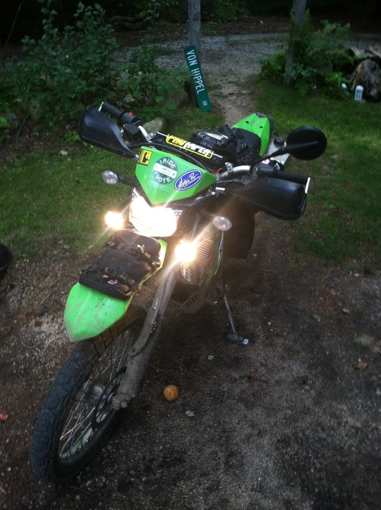

The "extra lights"...good for seeing and being seen. They use some juice @ 55w each!
