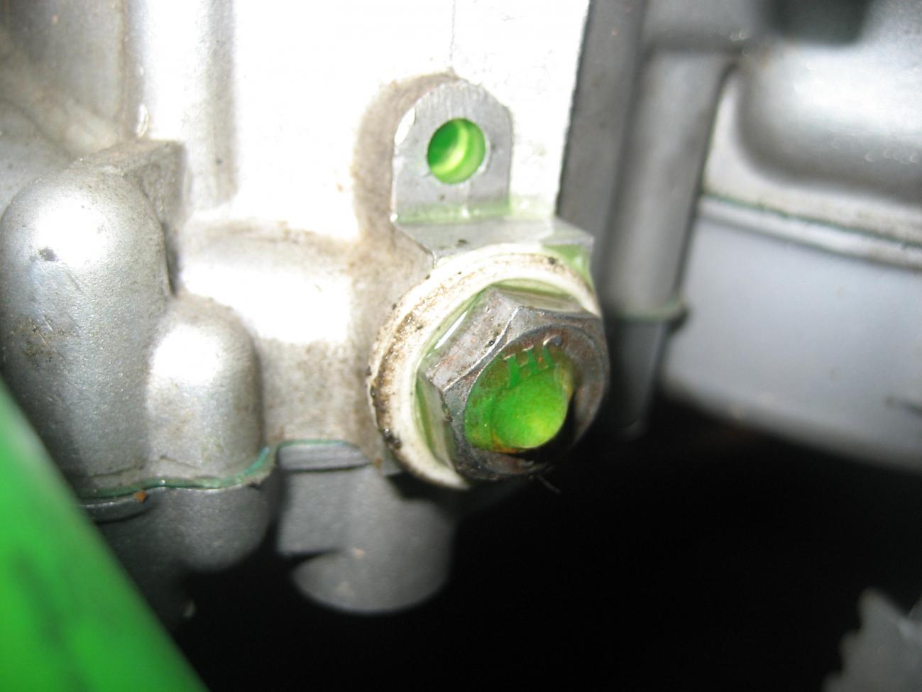

I have a problem w/ my kdx i just bought. I see there is a little hole next to my drainplug on my water pump that seems to be dripping, what is this hole for and how do i stop it? Thanks again

Here is a pic. of the hole.

If it is a weep hole, then it indicates that the water pump bearing seal has gone out.
