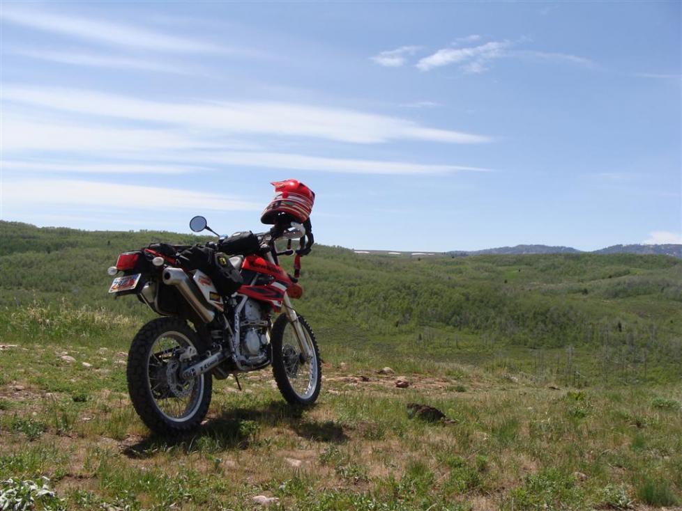

What you describe sounds very similar to the DEP muffler I'm running... right down to needing to weld an extra piece of pipe on, to get it to mate to the stock header pipe.
I'd love to see some pictures of it (mounted or not). Here's a picture of mine...

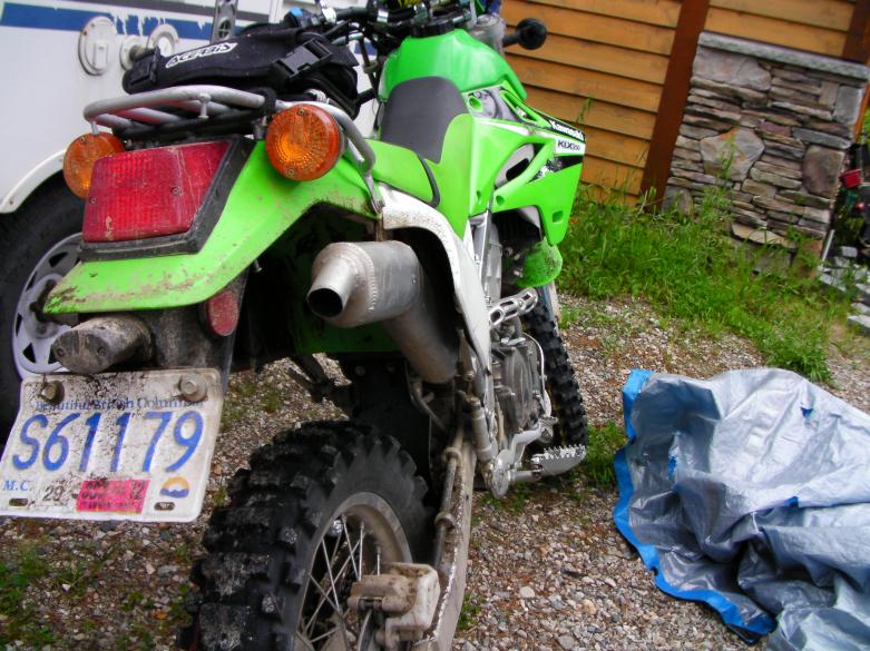

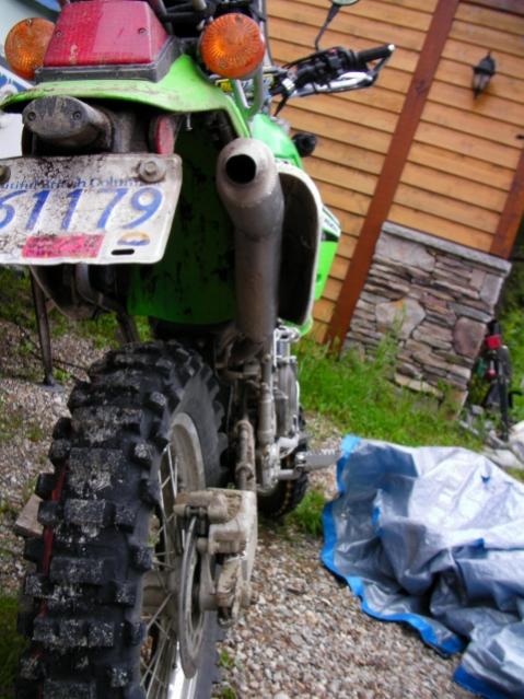

Default here is pic of muffler
heere is a few pics of the ktm muffler.
Attached Thumbnails muffler repack.-sany0281.jpg   muffler repack.-sany0283-480x640-.jpg
