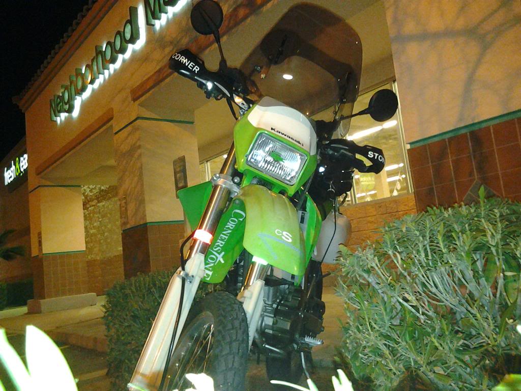

Seen here on the KLX

I got a good deal ...but... it was cracked...
Well it didn't crack until we dropped it. We were talking about craigslist scammers, test fitting the screen, as the unit slipped off of the loose mounts smashed in to the floor.
It was an accident. The downside of this particular universal mount is that it can detach it 2 ways. If you aren't careful- or are BS-ing- during install accidents may occur.
I hate to bring up prices since I'm such a wheeler and dealer and we all have our own blessings. However, he had it listed for $75 not cracked and that's what I paid for it after it cracked. The crack is only a hairline fracture near the mounting hardware which hopefully stays contained.
I experimented with some tucks tonight- la maiden voyage. When I went to the ATM to pay the wind was right on my face so we need to adjust that. There were also 4 kids amazed and giddy to see a motorcycle on the sidewalk and the motorcycle-man dance around his glowing machine.
The first adjustment pressed wind right in to the middle of my face. My face was all tingly when I got back from the bank.
After proper adjustment, I noticed a big difference on my neck and torso, alot less windy. When tucked I can hear headphones on low volume pretty clearly, more motor and less wind. When it comes to sound sometimes less is more. By eliminating wind rushing sound I could now hear other sounds which were already present and contributing to my statistical 25% hearing loss {unreferenced}.

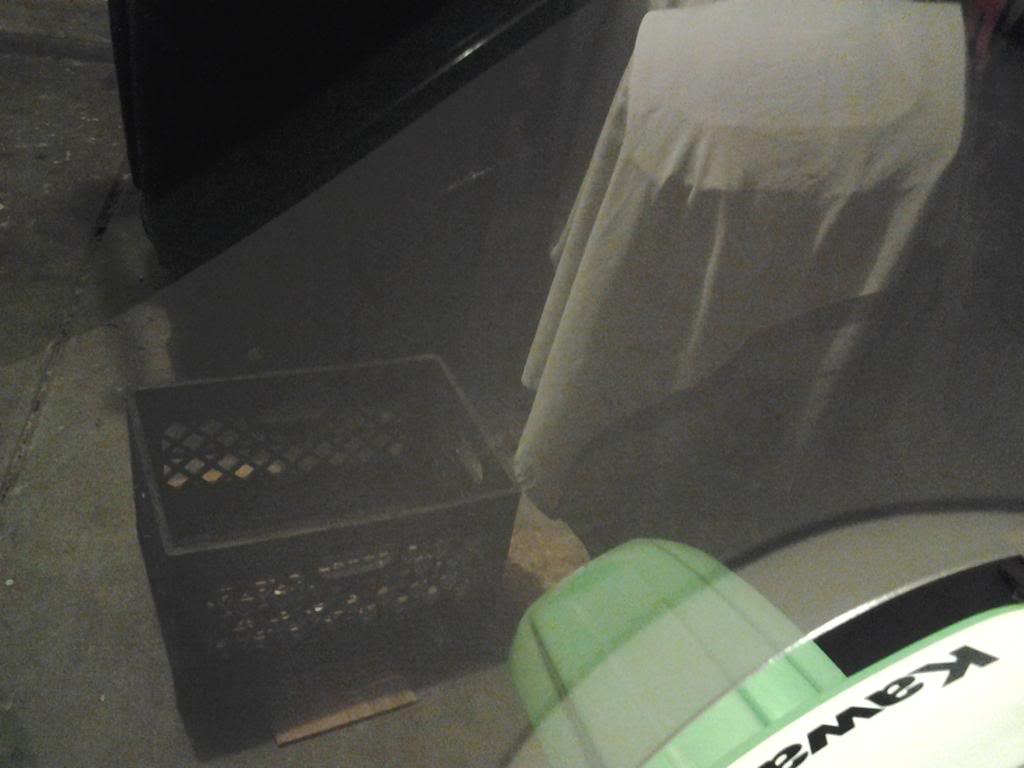

The windshield does cause distortion. There is an intentional rounded region in the design of the MRA Vario. I do not know a windshield brand that is distortion free and I would be interested if there is such. Distortion free optics are what make Arai, Suomy, Shoei and a few other helmet companies so optically desirable. A distortion-free lens is also important in the goggles industry.

Distortion aside, Vision is pretty good though:

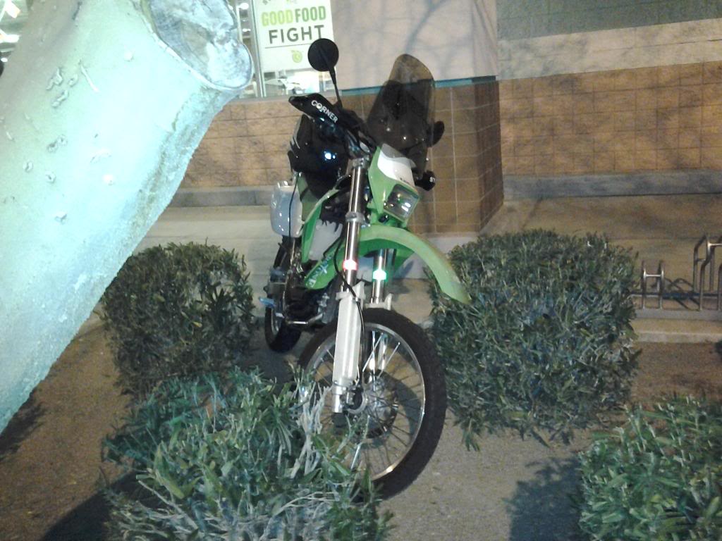

Here is a view of the lower screen alone on the bike:

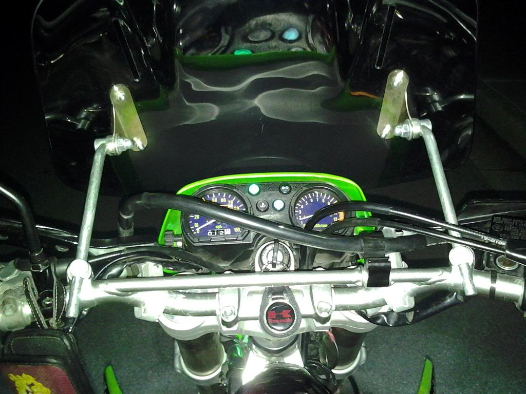

Here is how my screen is mounted for now:
Based off of MRA's universal design I now think any universal windscreen will the handlebars and number plate. But, budget, luck, making deals with devils and angels, housing market values and skill will determine your fit and finish.

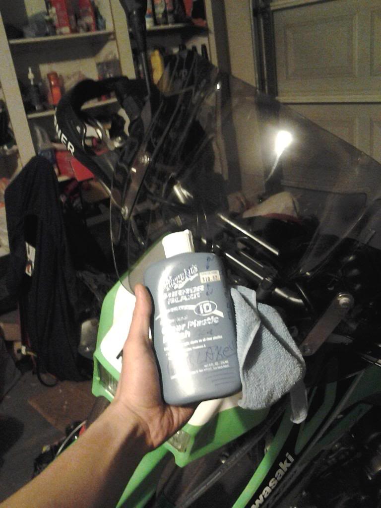

I also buffed the plastics briefly with Meguiar's Mirror Glaze Professional 10 and a microfiber when I got home.
