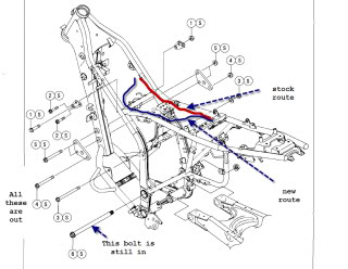

Here are all the bolts... Hmmm It may not tilt forward....
Well it should a little...
any body ever tried this
HHHHmmmmm maybe I can disconnect the harness from the front and then re-route the harness... hmmm I'll see how complcated that looks.
Old Jan 2, 2010 | 03:01 AM
SlapDrum's Avatar
Joined: Oct 2008
Posts: 674
From: So.Cali
That was smaller than I excepted
REd is the stock harness route
Blue is the new route
The only bolt left is the rear mount bolt.
I'm open to ideas....
Hmmm Maybe cutting the harness and resplicing all the wires is easier... I dont want to do that....
