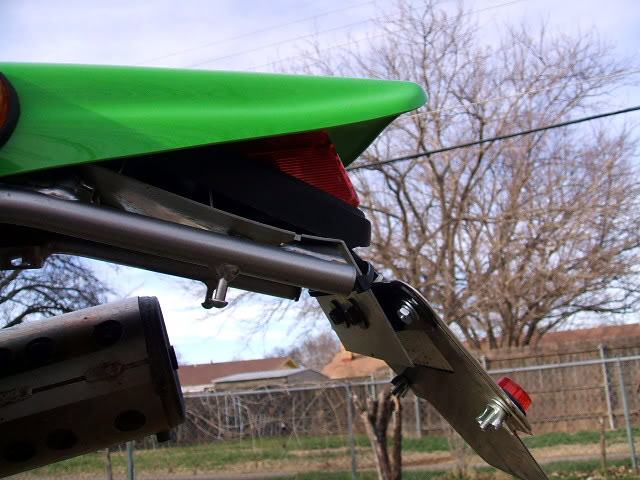

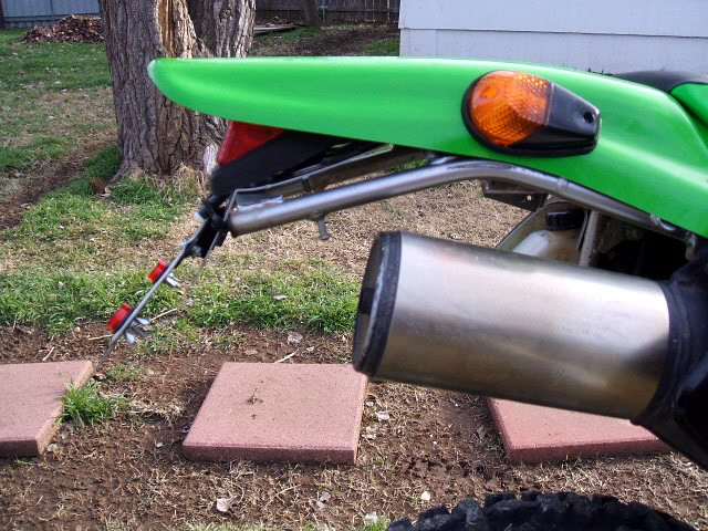

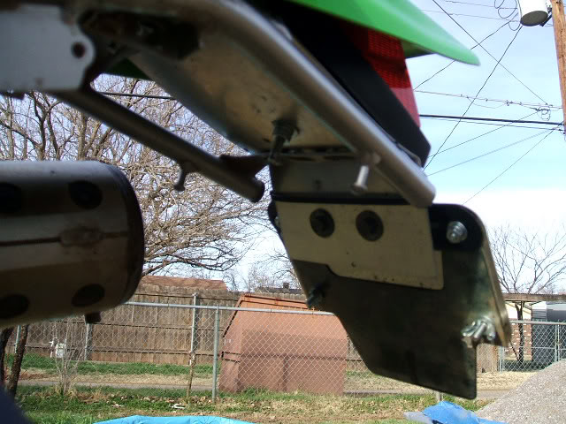

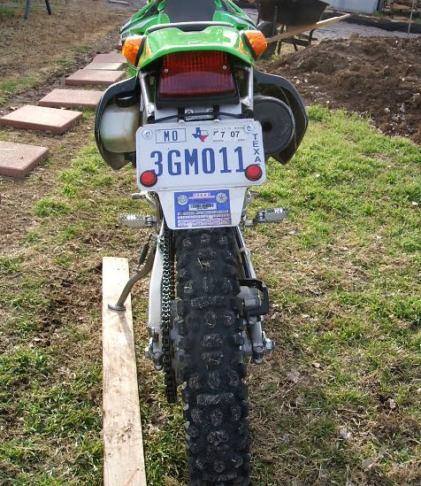

Ok, here's mine. I didn't cut the subframe off like Vurtles and Markturbo did. Just can't bring myself to cut it yet.
I used sheetmetal to make a plate to mount the stock light on and bent the plate down to make a place to mount the tag. I don't think the pictures show it, but I used two small. metal brackets to brace the sheetmetal where the bend takes place. I used rivets to hold the brackets/braces.
The tag lights are 14V, 1W panel indicator lights from the electronics junk drawer. They're held on with just a tie-wrap right now. I'm still deciding on how I'm going to mount them.
