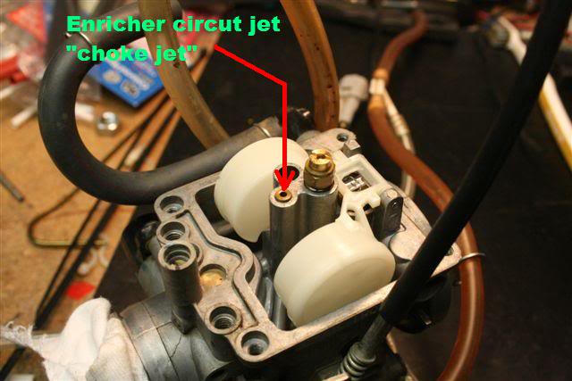

o mon dieu.. the search function works.. however.. I didn't find any posts that had a picture of which pilot is for the choke.. can anyone help me out there?
Old Jun 1, 2011 | 01:18 AM
  #65
I will give you that the search function here on KF is pretty crappy, but you can usually find something if you keep at it. It helps if you put quotes around the phrase you are searching for.
Dan
Here you go.
Dan
Here you go.
Thank you greatly.
