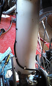

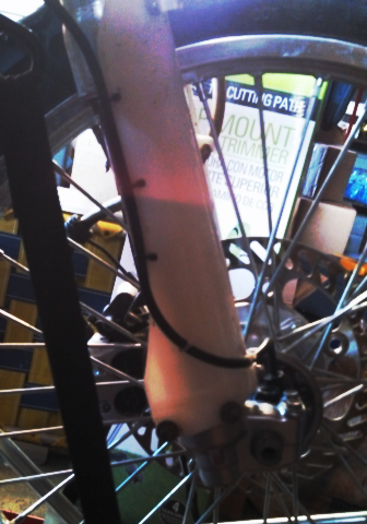

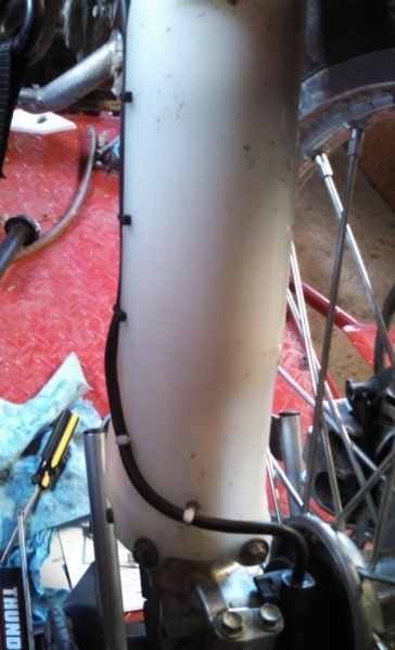

One more, I did zip tied my speedo line to my fork protector after drilling a couple holes. That thing hung out in the breeze down there.
This a must do if you trail ride through brush. I did just like KLX and routed the cable along the edge of the guard-nice and neat.
