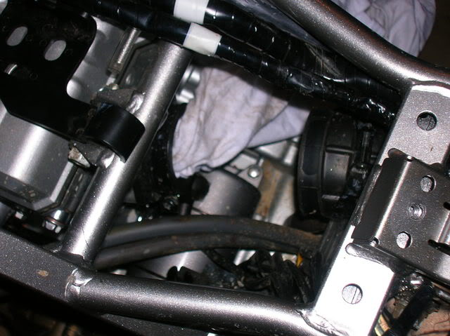

Once I got the seat, srouds and gas tank off, my first job was to get rid of the smog crap (KCR Air Suction System).

after I got that bad boy off:

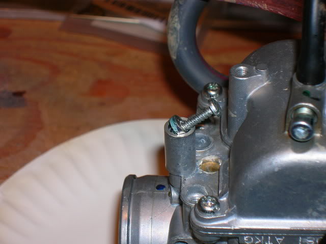

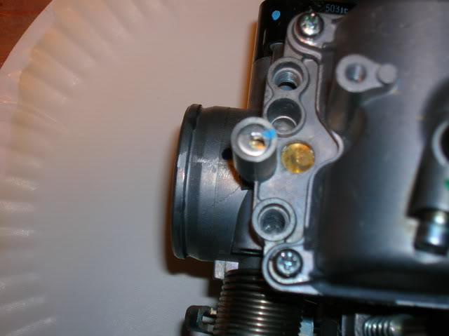

Next I turned the carb back over (upside down again) and poped out the pilot adjustment screw cap by drilling it very carfully, then using a screw to pop it off:

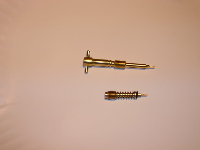

Once the cap was off, I screwed the screw in all the way to see what it was set at. (1 full turn).
I then took out the screw and replaced it with the Kouba adjustable screw for easy adjustments once the carb is back on:

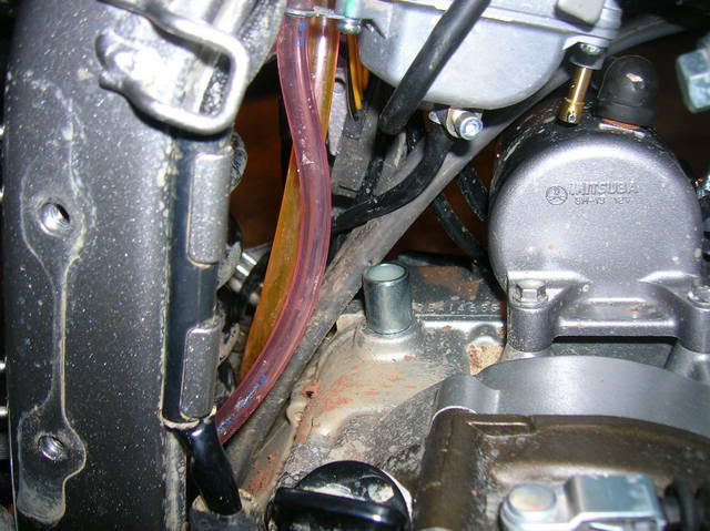

I then had to re-route the crankcase vent to the top of the air box ala the "Nobrakes" method since that method allowed the crankcase to still get the air it needs (vs sealing it off) and also put the opening way up top, so short of full submersion, there should be very little water getting into the engine crankase!!
I ran a 5/8ths inner diameter tube up from the cankcase opening and put it aside for the time being soI could finalize the airbox filter and lid assembly. I was having the darndest time getting that air filter box to fit......

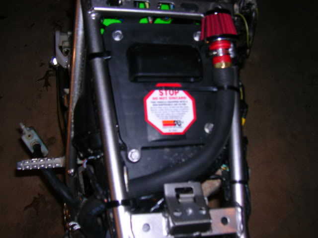

Man what a differnance the High Flow snorkel makes!! It lets so much more air in due to the much larger openings and much shorter distance that the air has to travel compaired to the stock snorkel...
Eventually I got that K&N air filter in!!

And with the lid attached again sporting the High Flow snorkel, I was ready to "Nobrakes route" the crankcase breather:
At first I routed it incorrectly accross the base of the frame where the seat clips in, I later had to change that position but was still able to stay up top!!

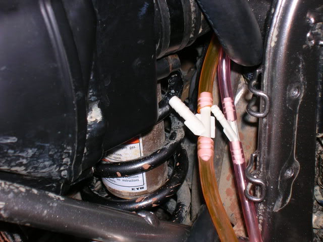

Next on the list (based on access still available!!) was completing the Carb breather "T" mod. This was very strait forward and I ended up using a Y connector from an Autozone store along with some windshild washer 5 mm tubing:
I routedthe secondary carb breather line

The air screw is "T handle" mixture screw from KoubaLink
If you use this site:
http://www.koubalink.com/fuelscrew.html
Just order the one for the KLX250 ( I don't think they have part numbers) Theowner is GREAT to work with and its a breeze to get. (yeah, there was NO WAY i was going to have to take all that appart for small adjustments to the fuel screw!!----SCREW THAT!!!)
