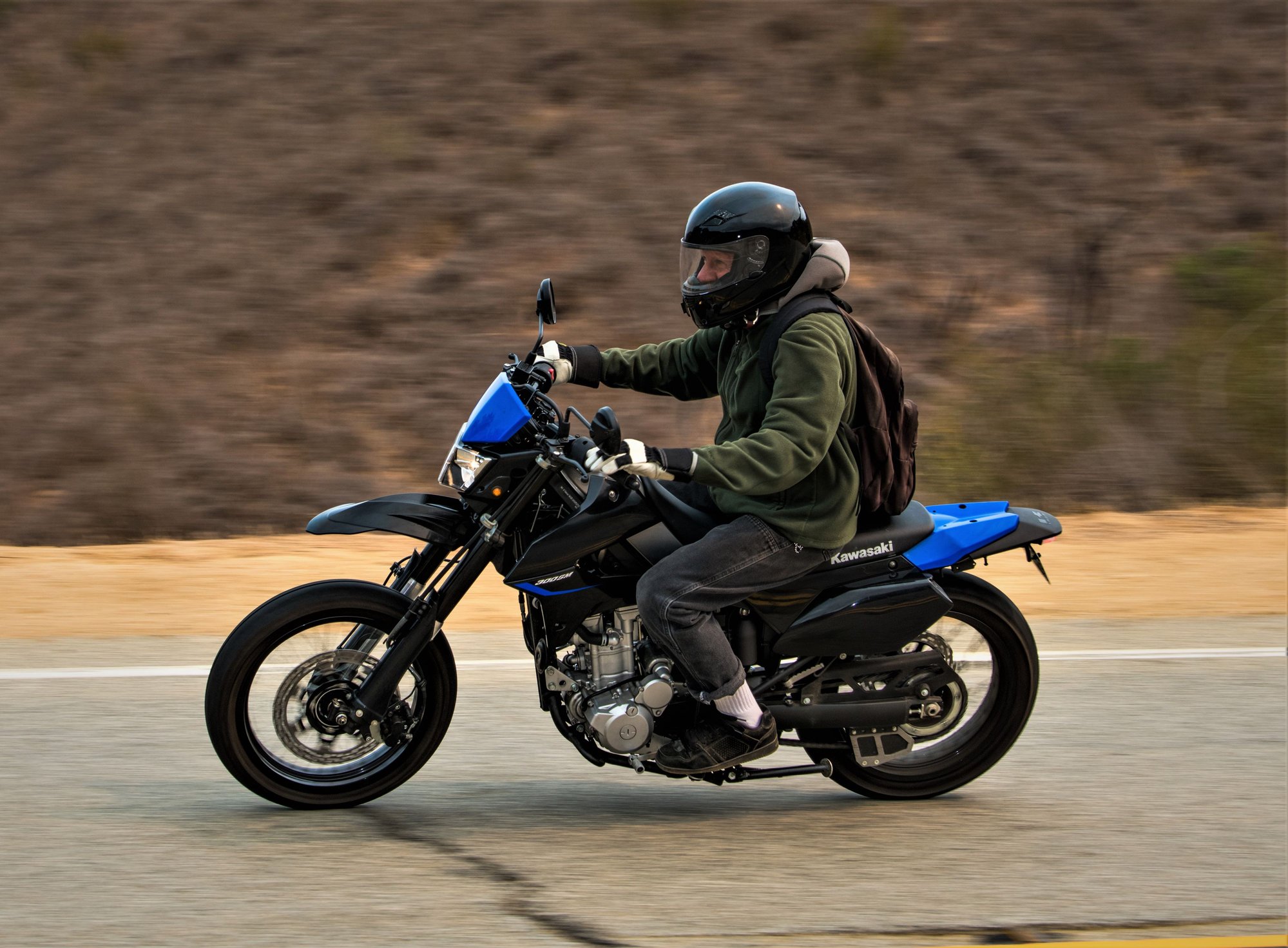

Originally Posted by greychinos
So did you try adjusting the spline position?
My bike is lowered front and rear, so one spline is too low.
(pic before mod)
(pic before mod)
Too low in what sense? That you'll drag the lever at your max lean angle, or that your shoe will drag the ground when upshifting?
Old May 26, 2023 | 08:03 PM
tooter's Avatar
Joined: Mar 2021
Posts: 477
From: Rural Unincorporated Los Angeles County
My shoe drags if it's under the lever while leaning left because the bike is really low. I'm never at max lean angle.
The larger diameter lever is the equivalent of half a spline, and its advantage is that it makes both up and down shifting easier without needing to relocate the arm.
