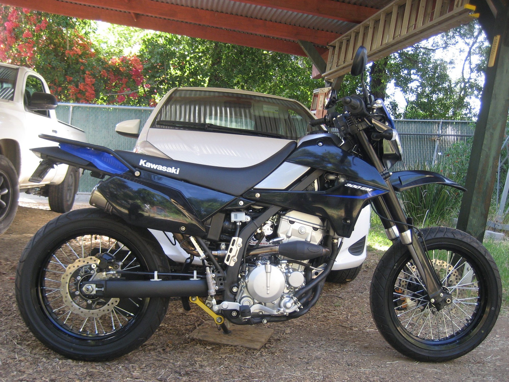

Because I weigh 136 pounds and only ride asphalt, I set the rear shock lockrings so there is no preload and installed lowering links so the rear swingarm is parallel to the ground. I live in the middle a Canyon so no matter which direction I ride, it's on twisted roads so riding a bike with a low center of gravity is an advantage.
